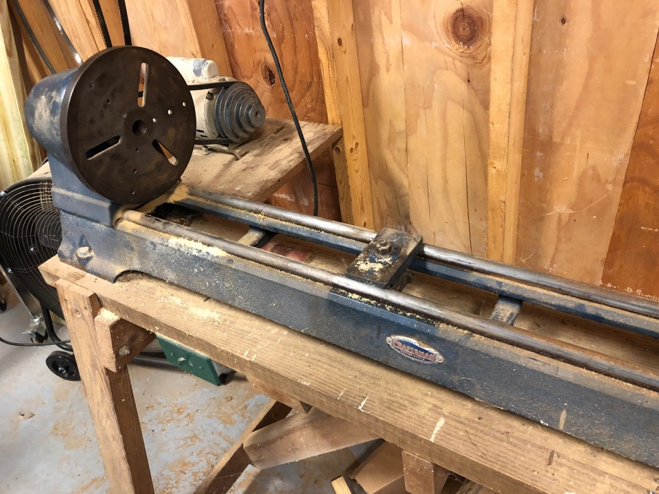

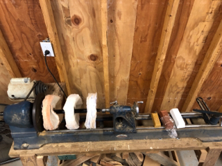

I bought this lathe when I was starting out turning from a neighbor who had it in their garage for over 40 years. I didn't know what to do with it, but for $100 I thought I could find some purpose for it. Turns out it will be my new polishing station (after being a storage shelf for a couple of years)

I did the same thing with one of those old Craftsman wood lathes that used a single large (2.5"~ 2.75") diameter steel tube as the lathe bed. In that case, I was able cut the tube down to just the length needed for the buffing setup, thus saving space in the shop. Your lathe would not be happy with that type of 'lathe surgery'. :eek::beat-up:
The option to select just the right speed to spin the buffs is a nice bene for this type of permanent lathe-turned-buffing-station. :biggrin:
Looks like you have 4 speeds available , with a 3:1 ratio highest to lowest . If my eyes are working correctly and that pulley ranges from 3 to 9 inch , and if you have a 1725 rpm motor on it , your belt is moving along at about 45 mph. No idea what size pulley is on the lathe , but I suspect it is turning at more than 1725 rpm .
