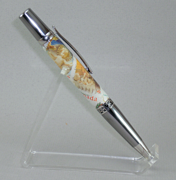

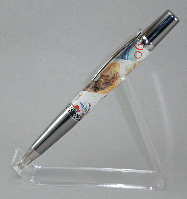

Since my mold was sized for 2 sierra's I made a second stamp pen. This one is using Christmas themed stamps. I can see I am going to need to make some bigger molds.
