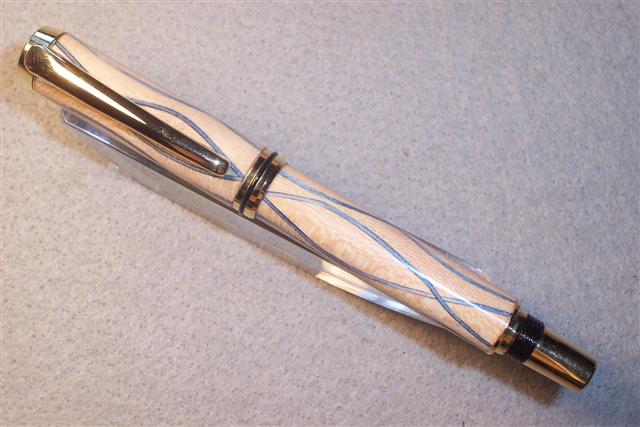

So I'll put it here instead
Sycamore and Eagalized"elusive blue" Baron
Eagle,
In the picture the blue almost looks like it changes colors depending on the position of the pen. Meaning it gets darker and lighter as the pen moves. Is this the case?

Ron the blue and also the sycamore have chatoyance but how are you moving the pen through your monitor.[^]
Actually I'm testing a new type monitor for a company and I have enjoyed writing with your pen now for several minutes[:D] Don't worry I'll put it back when I'm done.
I like this one too Eagle. But, again, I have to tease you and tell you that it looks like you're trying to emulate some of the acrylics! Of course, I'm very impressed with the precision with which you're able to make the "lines" in these blanks, and the smoothness of the curves. Very nicely done!

Actually Jim I am going full circle.
I think the Acrylics are copying The Creators heanenly work on burls but are doing it in colors.
I actually like the appearance of acrylices, but I can buy an acrylic pen anywhere.
To make a wood pen look like it is an acrylic that mimic a wood one to beging with, now that's an accomplishment.!

Great pen, as always Eagle. I have a question though. What method do you use to line up your grain when you assemble your barons? Slimlines and the like are easy, but I've had bad luck with threaded pens lately. I'm just looking for some guidance.

<br />Great pen, as always Eagle. I have a question though. What method do you use to line up your grain when you assemble your barons? Slimlines and the like are easy, but I've had bad luck with threaded pens lately. I'm just looking for some guidance.
The baron is easy.Cap it and just twist till it is right.
Everything turns in the fitting.( you glue you're screwed)
Dave--assemble the lower barrel as per the instructions. Screw the centerband/coupler assembly onto the lower barrel. Place the upper barrel over the coupler and align either by eye or with a straight edge. Gently press the cap down onto the coupler, then unscrew the upper barrel/coupler/centerband from the lower barrel. Finish pressing the coupler/centerband assembly into the upper barrel, then press in the cap. This is a four-start thread, so the alignment will only work with one of the four starts.
