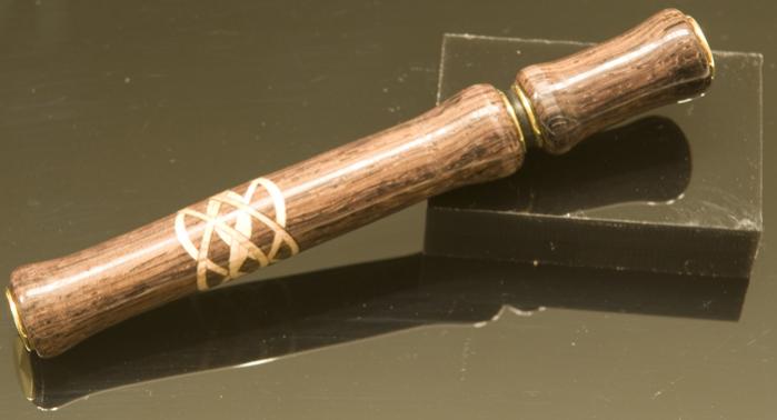

I've been trying to get a black background (without too much luck!!) using black plexi. Man, that stuff holds onto dust like the devil. and even worse is that it looks grey in my photos. argh.
here is a sample photo "out of the camera"

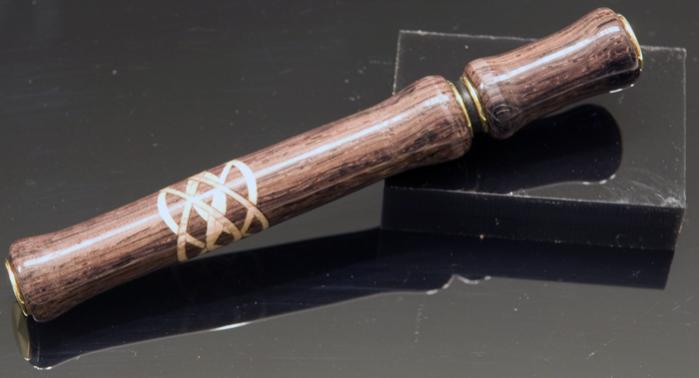

then this one is after I used photoshop's "auto color". This makes it much more black, but still grey - and not DEEP BLACK like I've seen so many folks do.

looks like there is something light colored behind it. Notice how the reflections of the cigar and box are dark. Put something black right behind plexiglas as a backdrop so it will reflect the black.
See if that helps and let us know!
I have used a mirror tile on the bottom and a black upright behind it. black shows dust like no tomorrow. what are you using for a light source?

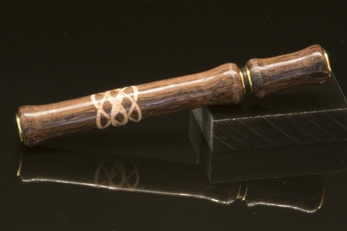

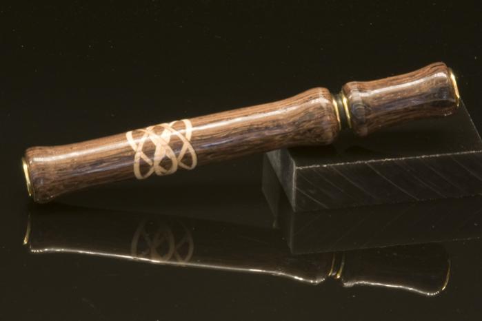

got the black posterboard, and got a MUCH better picture!!!
since I'm new to my husband's camera, it took me a while to figure out how to get into manual mode, so then I started messing with combinations of aperature and shutter speed to get the amount of light I wanted.
Also, my first attempt today was too "straight on", and I was getting a line across my background between the plexi and the posterboard, so I hiked up the tripod, and shot a bit more down. :biggrin:
Now to get some endust to try to control the dust!! then I'll be HAPPY. I also want to work on softening the edges and removing the scratches on my rest.
Thanks for all the tips. This photo is without the new lightbulbs (because by the time I remembered to get them, I'd already gone downstairs at Target, and wasn't going back up... my little one was starving, so we had to GO!)
Nice transformation and a nice looking pen.

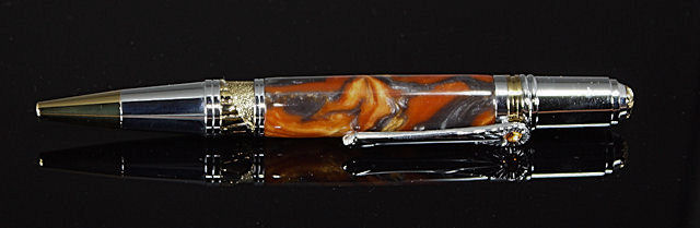

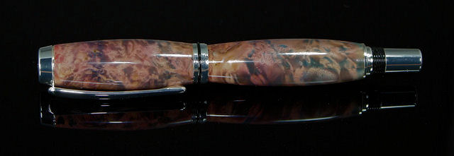

Use Black Acrylic, wipe down the plez with a chamois dampened with water. It will romove the static. We use it in the sign industry on Acrylic and polycarbonate just before applying Vinyl copy or spraying translucent acrylic paint. Photo taken with a Canon ZSi on full auto, 3- 6500 deg C/F in reflector. camera on tripod and using 10sec self timer
