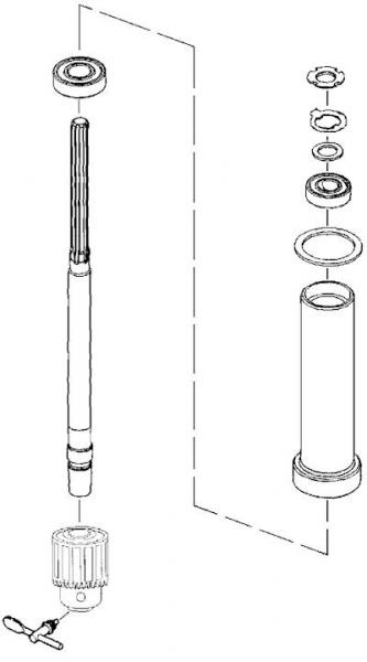

Now, I have a new dilemma. My Rigid drill press does not have a MT2 arbor. From what I have seen and read, it does not even have a separate arbor. Here is a parts breakdown:
attachment.php
In my other thread, Rick suggested that it is not a good idea to remove and replace the chick on a regular basis. I can certainly see that as a problem anyway so, that rules out this drill press in my mind.

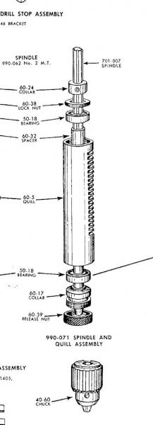

I also have a 1950's Atlas 1020 drill press that has been sitting in the corner of my shop. I could easily and happily re-purpose it as a dedicated threading machine. The problem is, it too does not have a removable arbor. I got the chuck off just fine but found out it has a JT33 spindle. The threading head I bought has a Jt3so it will not fit. Here is a breakdown of the Atlas:
attachment.php
Question...do they make an adapter to adapt the smaller JT33 to a JT3 that I could then install the threading head directly to the Atlas and not plan on removing it? That would be the best solution.
