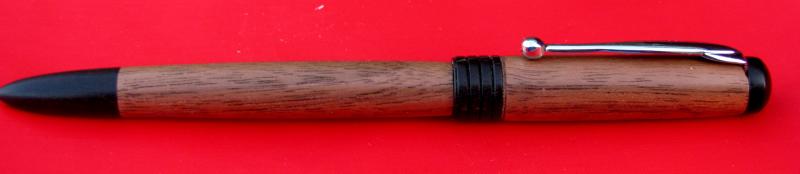

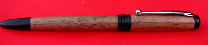

As many of you know I really enjoying playing around with slimline kits. I decided to make one with wooden tip, CB, and clip finial. Here is the first iteration so I know where the flaws are but wanted to show it anyway. I didn't have time to get a better picture before the neighbor boy wanted it. How could I say no..he didn't even notice the flaws. Next time I will not make a sleeve for the CB but use a solid piece of wood. Live and learn. The wood is walnut and African blackwood. All comments welcome good, bad, or indifferent.
Do a goo turn daily!
Don

Don,
You mentioned that you had used a sleeve for the CB. Did you use a brass tube? and why won't you use one the next time? I have used a brass tube as a sleeve for a CB and also not used one. I have found that the wood alone wears after a while and becomes wobbly.

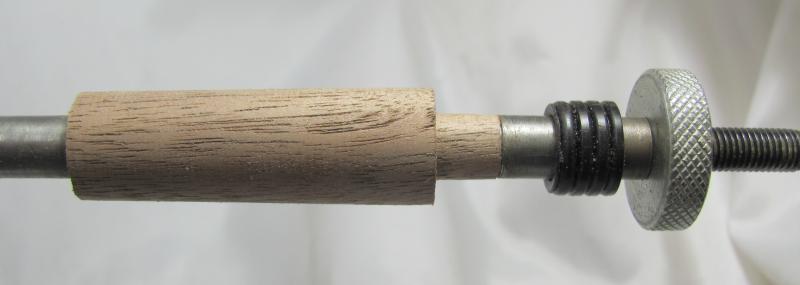

Hi Cindy,
Maybe this picture will help. The upper barrel pictured has a tube in it the entire length. I turned the CB then drilled a hole in it. I turned a tenon on the end of the upper barrel and glued the CB in place...after it was broken. :mad::biggrin:Next time I will drill a 7mm hole, part off the end of the barrel down to the tube and glue the CB section in place and then shape the CB section. I don't know why I didn't do it that way to begin with?
Do a good turn daily!
Don
Don,

Hey Don,
I'm glad to see that you have finally learned how to modify a Slim-Line pen. (smile)
Seriously, it is a nice pen, and should be a good article. Good job on it.
Thanks Russ...This is another idea that probably origingated with you.:biggrin: I've learned from one of the best. Glad you are feeling back to normal and posting again. Continue to improve.
Don

Don, I'm in your camp. I like the slimline for the same reasons. It is cheap and fun to modify. I don't make pens to sell, only for fun and as gifts.
I like your pen.
Well Don, I have all but quit making slimlines. I think mostly because I got tired of them and wanted to move on to the "big boy" pens. After seeing your slim, I think I'll go back and "free wheel" with few slims!
Nice work and I can't wait to see version 2.0!
Nice work Don, I really like the shape of the Nib, I need to go and look at some of your older slim lines, I seem to remember there were some nice pens.
I'm just a beginner, so most of the pens I turn are slimline. I am still turning LOTS of the "funline" cheapies and giving them away. I'm LEARNING. I have experimented with the shape of the pens, turning them larger than the slimline design, but that made them "wasp waisted" . I saw a slimline someone posted here without a CB and have turned several of those. The one I turned today had an 8 piece radially segmented blank that Jim made from his whiskey barrels. He sent it to me in a trade, but it was only a half blank, so I turned it as the slightly longer top half and added a gaboon ebony barrel, turned smaller so it looked like the designer pen.
If I knew how to post a picture, I would show it off!
I am beginning to branch out into the soft grip and designer line now, as I gain confidence. I am still scared to death of the skew, but the skewchigouge is my friend! I have finally mastered a nice CA/BLO finish, and after more than a hundred pens, I am still having fun, and that is what it is all about.
Sharon

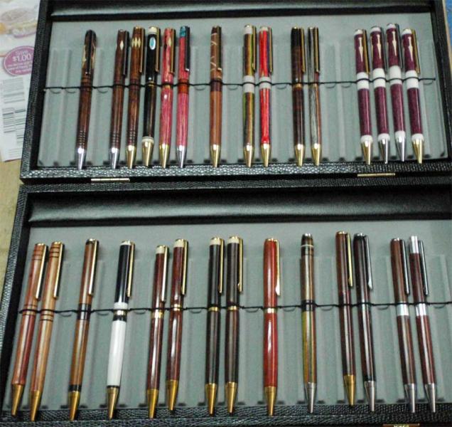

Here is a photo of my slimline box.
As you can see I do a lot of different things to them.
Willee
Hi Willee. good to see you posting again. I carried one of your (now mine):biggrin: pool cue inlay sierras today the you sent for trade in those maple blanks from a few years back. I get nice comments on both of them each time ZI carry one.
Happy slimlining....they are fun.

Slimline kits have got the be the most useful of all the pen kits.
The Chrome is durable and cheap.
You can let your imagination run wild and create just about any style from that one kit.
Willee
Thanks to articles by you and Russ, I look at slimline kits in a whole new light.
Now you have gone and added another wrinkle into the mix! :smile:

Hi Cindy,
Don
Don, that's what I alway do...seems the easiest.
It is the easiest and the way I usually do it. But, I was using parts from an euro and zeroed in on the CB and my brain didn't let me think of the easy way. Oh well, now I have some fodder for the next deadline. I'll show 'em how it can be done easier.
Don
