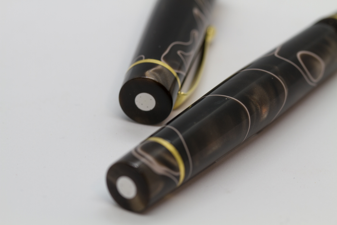

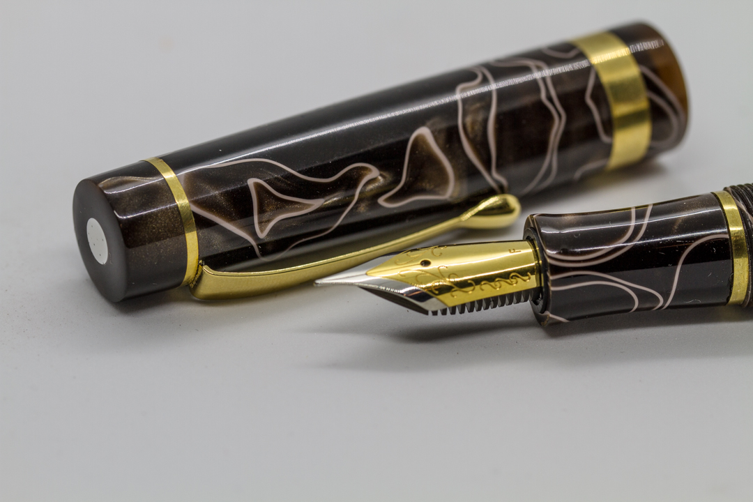

What a Beautiful Pen Jordi,
Magnificent Blank, Beautifully Turned, Fitted and Finished,
Excellent Profile and Proportions,
Superb Machining, Love the Treatment of the Cap Finial, and Body End, with White Inclusion.
Beautiful Center Band, Clip Band, and Matching Body Band.
Did you also Manufacture the Clip, Bands, and Section ?
I am sorry I cannot help you with a Name, as I am not that Imaginative.
Thank you for including the Close up Function with your Photographs, it enables us to have a good up close look, at your Outstanding Pen.
I am certain that Your Father will be very Happy and Extremely Proud.
Could you please include some details on what materials you have used in the Pens you Post, it will be of Great assistance to up and Coming Kit-less Makers to see what others are using and what results can be obtained.
Congratulations,
Brian.

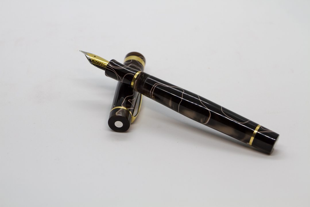

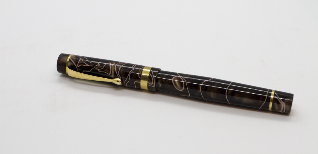

Thank you very much for your encouraging words, Brian.
No problem at all about answering your questions.
Materials: the pen blank is an acrilyc made by Conway Stewart called Mocha bought at the turnersworkshop in UK. I have to buy two pen blanks for each pen.
Bands and rings are made from a bar of brass that I have at the shop.
clip is bought. I would love to make my own clips, but by now, I dont have the time I would like to learn how to make my own clips (I had a son 4 months ago...)
I work with a metal lathe and I finished the section and some parts of the pen with carbide woodturning tools. So my pens are partially machined and partially handmade.
Section is manualy shapped.
hope this explanation help some makers to go into kitless pens.
Jordi
