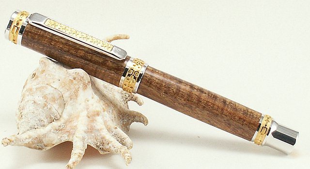

I got some really nice curly Koa from Dario some time ago and have been saving it for something special. I thought this Jr. Emperor rollerball was it, but now I'm not so sure. I'm thinking of cutting it off and redoing the pen in African Blackwood. Any thoughts?
Update 8/6 - I wasn't sure I had time to try a different wood before the show I was scheduled to be in this weekend so I just took it the way it was. A customer asked to see the best rollerball I had so I showed this to him, he tried it out and bought it with no hesitation. He really liked the wood. And the rest of the show was just as good.

Hi Gerry,
It's a nice blank, The pen is very nice too, I'm not sure this blank suits the pen hardware of this kit design. With kits at this level of cost I really am very selective with the blanks I choose. I would think about buying other spare tubes and turning some other blanks of other materials and consider a change over if if you like. I often buy a few extra sets of tubes and do this with my expensive kits, I do not turn them down to final size always before I do the comparisons....because if they would look better on a Jr Gent or Jr Statesman then I save the final sizing for the kit I like on the blank I turn...maybe I'm alone with this thought, but I can't see what the blank looks like till I turn it, so I turn it round on the spare tubes and then decide.
Just my 2 cents, It's still a good looking pen Gerry

Gerry, it's a very nice looking pen, but I like Jim's idea. I know that many feel like overstated materials detract from the hardware of the higher end kits, but I'm not sure I fully buy that. The only problem I have with the Koa and this pen is that I don't think it's striking enough. Yes, it's moderately curly, it's just missing something. JMO

Much as this hurt me...from the pic, another wood might work better with Gold Emperor. You will be the ultimate judge since you can really see and feel the pen.

I think Billy and Dario stated what I was thinking. We can sit here and tell you it's just missing something but you are the one with it in your hands.
African Blackwood or a real nice dark Ebony would IMO look great with that kit.

If you can use that Koa on a different pen, go for it. But, I sure would NOT turn it off, making it "throw away" wood. (JMO)

Thanks to everyone for all the comments. I got an email from someone whose opinion I respect a great deal and, at least for now, I'm leaving it alone. I just need to market it correctly.
The tubes for the Jr. Emperor are the same as the Jr. Statesman/Gentleman version 2, but obviously different bushings.

This may sound crazy, but I bet that pen would sell in two hours in a hotel gift shop in Maui. There are plenty of Asian business men with plenty of money that just might want to take home a beautiful pen made from native wood. Hawaii is to Japan what Disney World is the the eastern US. I am guessing that is what Gerry meant by marketing it correctly.
By the way, looks like you did a great job on the pen, Gerry! Like the others, I am not sure if the combination does anything for me, I would have to see and feel it.
