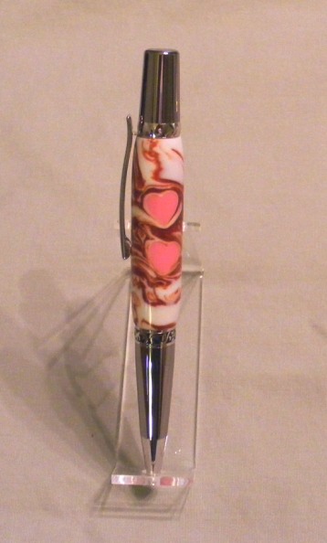

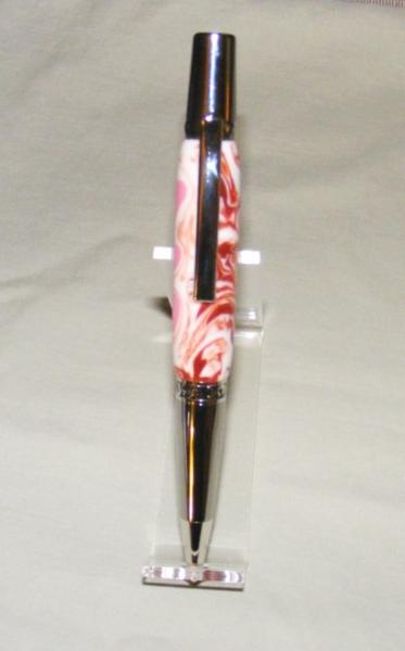

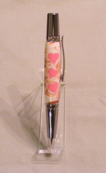

I love turning these blanks...they are quite challenging, but worth the effort....Hope you like! thanks for any comments and thanks for looking:smile:
