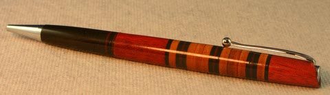

Here is another in the style of the Challenge pen (From my friend Jay Pickens)I posted a few weeks ago and on which Russ F. improved upon in his "Jay-line" with the twist tip. This pen has blood wood, African blackwood and........... leather disks! Take a look...comments welcome: good, bad, or indifferent.

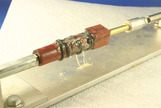

Glue a wood piece on one end of the tube. Stack on the leather disks and add another wood piece on the other end and compress it all together. Glue with 30 minure epoxy...use it liberally between the disks and even on the surface. Compressed disks turn better than non compressed ones. Use more disks that it takes to fill the tube then press them together. Here is a picture of the blank while the glue is drying.

Another bit of information: The leather turns nicely with roughing gouge, skew, or round nose scraper. Of course, the sharper the better. The skew seems to cut the leather cleaner and the scraper seemed to make the leather surfaces a little fuzzy....

Rob: Does it look a little out of balance. Maybe blackwood on each end would help?

It hardens. Can't really tell that it is leather. Maybe with no finish it would feel different.

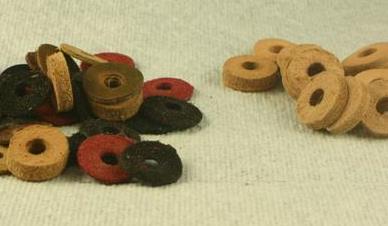

I actually used a leather hollow punch to stamp out the disks and a smaller one to punch out the holes. I used a 7/32 to punch out the holes and a 3/4 inch to cut the disks. I've not tried to drill the leather. I had the punches from another hobby interest.
A good place to buy leather: Maybe there is a saddle shop in your area or a shoe repair shop or other place that makes things from leather. Any of them should have scraps. Even small scraps will yield 3 or 4 disks each. A farm supply store such as TSC or Atwoods should have bags of leather reminatnts. Any hobby store and even WalMart has bags of scrap leather pieces.
