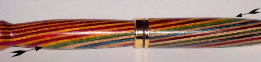

I use "Super T " for most of my glue-ups . The pic shows the glue line between 2 different colors of Dymondwood that I glued up . Super T gives you aroung 45-50 seconds to work and it's about the consistency of molasses.
<br />
