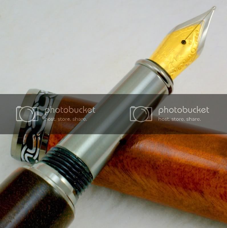

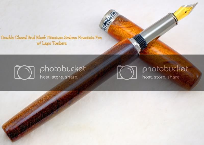

Had another Black Titanium Fountain Pen kit from ArizShiloutte and a really nice piece of Lapo(Harold in CR...this stuff is great). So what to do, why let's sniff some more CA fumes(that's getting really old by the way)....
Anyway.....
Close-up:
And the whole thing:
Now to learn the clip thing...comments/critique?
Scott (thanks for looking) B
I agree, the shape of this one is sopt on! You really captured the lines on this and it's a solid looking turn. I'm getting hungry for some of those pin chucks.

WOW Scott. I just saw this one. Very Nice. And I agree with Ruby Pen Turning. I like the taper on this one better. And I should have my pin chucks today. Can't wait to try them out.
Well, this is like the 6th time I've eye-humped this one since it was posted. Looks awesome.
Dude, that just sounds wrong in so many ways........but funny:eek:
Thanks for the kind words, if I can get my lathe back on the table that the wife has claimed to be her PR casting table, I'll make some more! Been eyeing a piece of Eastern Red Cedar that is crosscut for awhile now, and I'm thinking.....
Scott (it's a big chunk too) B
I need to order that mandrel. I have always used red heads from the big box store. they work but are weak after a few pens. That looks stronger. Your pens look great and the shape is nice as well.
