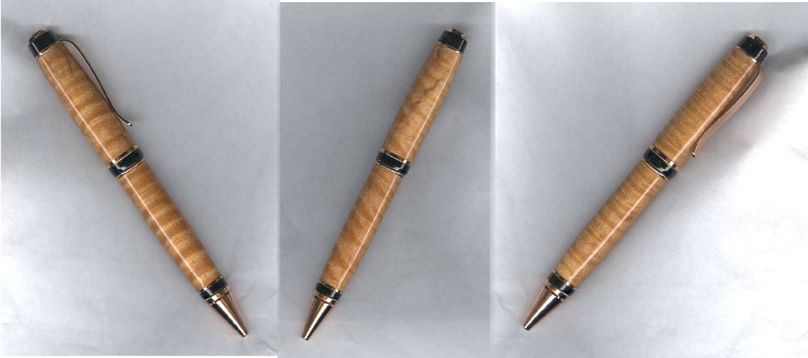

Maple, PSI copper kit, BLO and CA.
Originally posted by Geo in Winnipeg
<br />I'm beginning to like maple. Great job on the fit and finish. Is there a slight dent in the lower copper part of the CB or is it maybe a reflection in the photography?
Must be some type of refraction with the glass on the scanner. It is in the same spot on all 3 pictures. (The first picture was flipped)
I am not knocking it but I must add, no MM was used in the fabrication or finishing of this or any of my pens. But then, I have never tried any either!![:p]
Cozee, I was skeptical about MM at first. I finally got some and BOY does it make a difference. Trust me on this, I'm a cheap miserly ol ba#@$^ and wouldn't buy it if it didn't work. That, and you can do dozens of pens with the SAME 2X2" pieces so long as you always wet sand and don't heat it up much (I also rarely use it directly on wood, only the finish, which sorta makes me a black sheep around here).
It's got a lot more consistency in the grain pattern, and the 12,000 grade is actually about as fine as a 6,000 to 8,000 grit sandpaper.
My final step on CA and acrylics is 12,000 and then I use 3M's Finesse-It II polishing compound, using a scrap of automotive leather as the applicator. Insane polish.
