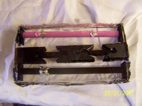

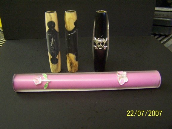

These are the results of my first casting with Alumilite in my new pressure pot. As you can see, the result is a failure but I learnt a lot, so not much loss. First, I copied Steve ( SteveJ72 ) by using a foil dish for the mold. That is an excellent idea Steve, as you can custom form your mold to suit the amount of blanks you do without unneccessary waste. Next was to measure and mix the two parts. I think I did ok with the measuring, but it was just a reasonable guestimate. I mixed the two together for what felt like ages as I was scared they would start to gel. The last two steps are probably the cause of my failure.
I just left the pot under pressure over night and was very pleased to see absolutely no bubbles when I tore the foil off. There was a tacky part to the surface in one area of the block. But the rest felt rock hard.
The things I learnt are;
1. I must measure much more accurately.
2. I must mix for longer
3. Sraypaint does not stick to CA, but seems to repel it.
4. For the effect of bringing the image to the surface, the resin needs to be a bit thinner than I could do with the items I chose to imbed.
5. For really clear resin, I need to make sure my work area is clean. See the dust spot above the skull.
I'm not sure if it was the short mixing time or in-accurate measuring that caused the soft spots. See the white marks on the wooden jigsaw attempt.
The pink one seemed ok till I over turned it and touched the edge of the flower and the butterfly.
Oh well:([:I]:D

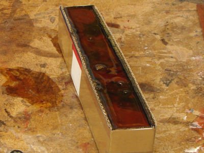

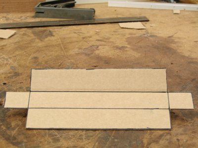

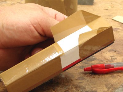

Another good way to make a mold that is a little less flimsy than the foil is to make it out of cardboard and tape. Then once the blank has been cast you simply cut the cardboard off with a bandsaw or turn it off on the lathe. Here is a picture of one I did:

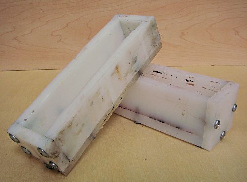

Of course then there is the re-useable molds I make from the white plastic cutting boards...

I have had a closer look at the spot above the skull and I think it could be a short crack? Any idea's on that anyone?
Another thing I would like to ask is, has anyone double casted? What I mean is casting a finish piece in another layer. For eg, the pink one above, if I stuck a transparent label on it then re-cast it would it work?
Steven - first of all, nice work. Double casting works fine. IMO it is the best way to get perfect lines on segments. You can also bring imbeded items closer to the surface by turning a cylander below the final pen diameter, either wood, plastic, or cast then glue the item to the cylander and cast clear (or color if it will be at the surface) around the object. Takes a little more time but can make some interesting background effects. Keep up the interesting work.
