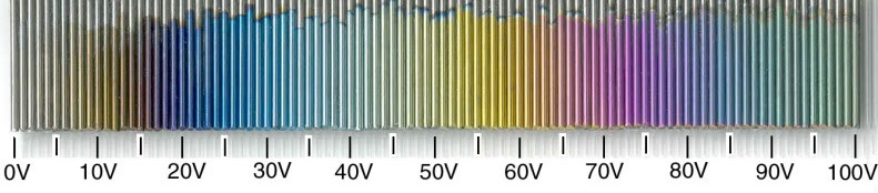

I have attached a colour chart which will give you a rough idea as to what colours can be acheived with different voltages.

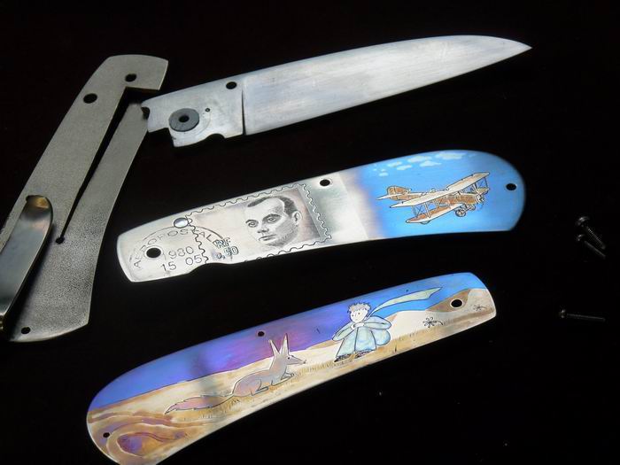

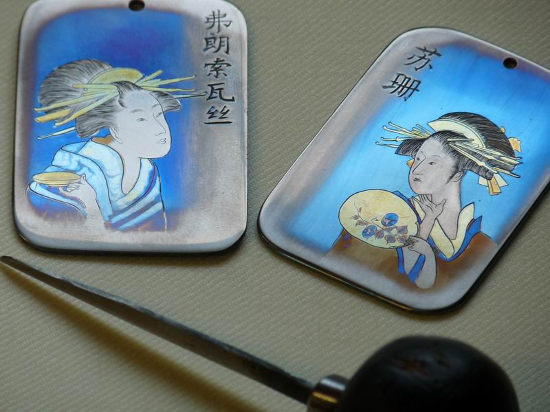

not that i want to make you explode with excitement....... but you can do a little bit more than just mask and apply a second colour with the right skills
Credits to Jean for the artwork. This is not my work but does give you a good idea what you can accomplish. il go into details in the tutorials on how this is done.
As for durability, yes its very durable. not something which will simply rub off by being handled. though the good thing with anodised Ti is its easier to strip than sealed aluminium if you dont like the look of it, and want to change it somewhat.

The colour takes seconds to appear. literally 2-3 seconds. the images you see above are alot easier than you think. the skilled part is outlining the pieces. Jean does this by hand using a press engraver which is the tool you can see in the picture with the two pendants.
Once the outline is there you then colour in between the lines.. you do this using a tooth pick with a strand of wire placed towards the tip with the electrolyte soaked up in the toothpick. you then treat it like a paint brush and vary the "paints colour" by tweaking the voltage as you go.
Il be manufacturing the tools for doing this soon, maybe you would like to demo one ;)
Material thickness is irrelevant as you are actually building an oxidised layer on top of the surface of the Ti. the only variation it would cause is the surface area of the titanium which would have an effect on the ampere, though with dealing with the size of the pieces we are using its negligable, at around 0.07A per square inch
