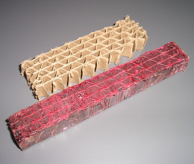

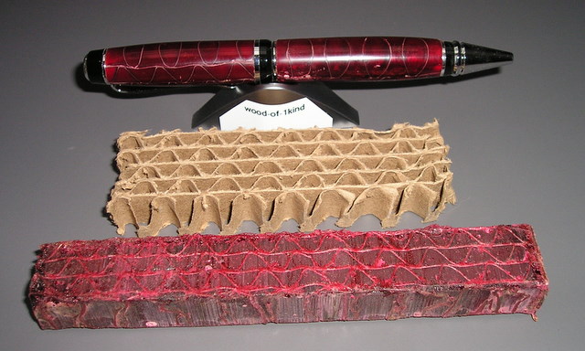

I've done a number of 'honeycomb' corrugated blanks cast with Silmar41. To add inerest I mixed in some coloured enamel paint to the mix. Overall results were OK but not overwhelming. Give it a try.
Here are some 'corrugated' cast pens.
