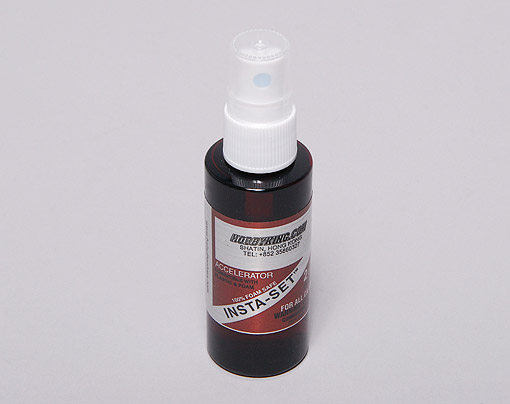

Something else I have noticed is that there is a big difference between different brands of accelerator. I once poured one brand into an almost empty bottle of the other and ended up wasting 2oz of accelerator because the CA bubbles and turns white if I spray it with this mixture.
These are the only 2 brands I have ever used but the E-Z brand is much better than Insta-Set IMO. I notice the E-Z evaporates nearly instantly and the Insta-Set leaves a slippery wet film of overspray on the lathe that takes awhile to evaporate. It may leave something behind between layers of CA.
