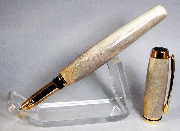

I got this off Ebay a year ago with some other antler. The buffalo horn was old and gray with some deep cracks on the outside. I figured since I’ve been turning for almost 2 years and graduated from beginner to amateur I could handle this. The marrow was old and it looked yellow. I was afraid it would fall apart when turning it, if I turned it that far down. So, after I cut it, I dripped in some thin CA into the marrow. I think I counted to 50 drops twice for the cap alone. I did drip in some medium CA into the other end as to act as a cap for the thin stuff being dripped into the other end. I dripped a lot into the closed end barrel. I was just afraid it would fall apart as it was so old. Maybe I went a little overboard, however it came out looking real nice with no cracking and the marrow didn’t crumble on me.
It turned like a rock. I had to sharpen the skew several times to get through each barrel. My skew wanted to constantly bounce off of it. I ended up using a rasp file for awhile to get it to the shape I wanted.

The closed end was the end of the horn so there wasn't any marrow down there. It was just white with some gray. The marrow on the other end was yellowish. Maybe because it was so old.

Thanks for the nice comments. That yellow color is the marrow. Maybe it turned yellow with age. It seemed kind of soft when I cut into it, that's why I dripped so much CA into it. It kind of looks like a stain, but it is the natural color that was in there.

Julia, the smell was the same as deer antler. Even with as old as it was, it still smelled like a dentist office.
I think Jeremy is right about the black being like a sheath. I was hoping to have some of that darker coloring, however it was there, and then it was gone. There was just that darker color under the almost black. Deeper down was the nicer white coloring. The closed end is close to the tip of the horn. I only had about an inch of the horn left after cutting it for the pen. I was going to take a picture of that, but that little bit left doesn’t really show anything. It's definitely not like the black Water Buffalo horn you can get that is black all the way down.
Tim, you did a nice job with an old antler. I have been working with some old ones recently and found that like you, I went through a lot of CA. The only real difference in the way we made them was when my skew wouldn't do the job, I reached for my roughing gouge( I know I'm going to hear about this one) and turned it down gently to a cylinder that I could work with. I am going to have to try the rasp and see if it works better for me. I really like the fact that you didn't bleach out all the character.
Nice save, well done. I have never seen buffalo/bison horn that was anything but black. If you hadn't said it was buffalo, I would think it to be antler. You do mention marrow. Horns on buff or bovine have a marrow core that falls out when the horn is cut off the animal.
