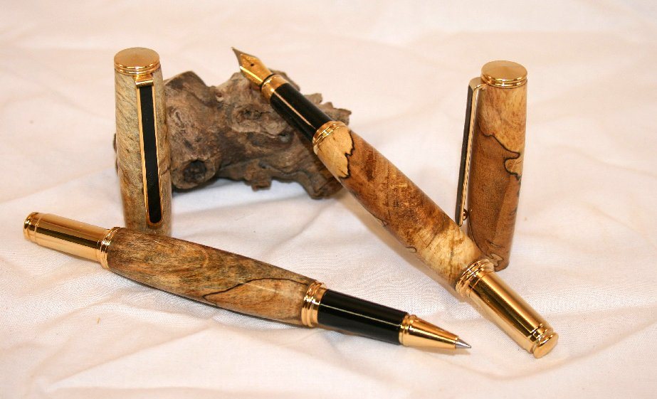

I'm finally getting time to set up my photo booth again and take pictures of what few pens I have had time to turn. I see that I need to iron the sheet for the booth!
Anyway - this wood was cut last summer from a tree that fell on the west side of town (Bloomington, IL). With chainsaw in hand, I separated the good stuff from the bad (heavily infested with termites) - finding some that was spalted and had received a visit from the Ambrosia Beetle. These two pens are for a friend who had me guest lecture at her university this past weekend.

You hit the nail on the head regarding style - these are very popular kits - and not real expensive compared to the Jr. Gents. I like them for gifts for friends - always seem to be a big hit. I have two complaints about the kits - maybe you have some experience you can share about the second complaint that might help me?
The first is that you have to notch the finished blank for the clip - something I hate doing. It always works out just fine, and I've had no problems with the pens - but I just don't like that step.
The second is that these are the snap in type - with the plastic insert in the cap. I've really had to take a lot of time to get the insert in just right. If it isn't in perfectly, there is either a gap between the cap and the body of the pen when put together, or the pen tip doesn't reach the insert properly inside. The biggest problem is that I haven't found a way to adjust it after I have already installed the clip into the top tube so I spend a lot of time doing a semi-dry fit test. CSUSA suggests using a #1 or #2 Philips screw driver to tighten or loosen after installation, but that doesn't work on the tightest settings.
Advice?

Roger, the pens look nice. A nib cap adjuster tool is available and works much better than the screwdriver. It has four ittle teeth on it to grip the notches in the plastic insert. I think it costs around $5. CSU and Woodcraft carry them, maybe other places too.
Originally posted by mrcook4570
<br />Roger, the pens look nice. A nib cap adjuster tool is available and works much better than the screwdriver. It has four ittle teeth on it to grip the notches in the plastic insert. I think it costs around $5. CSU and Woodcraft carry them, maybe other places too.
Fantastic! I'll order one right away. Thanks for the information!
