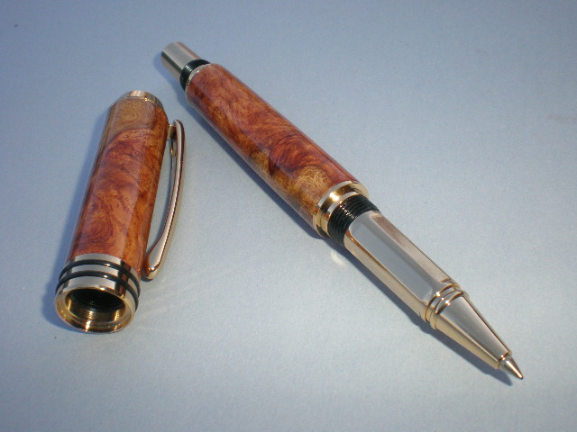

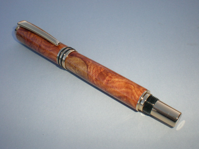

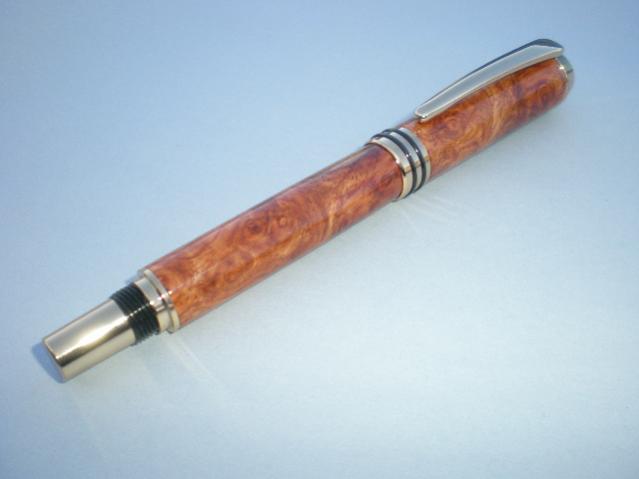

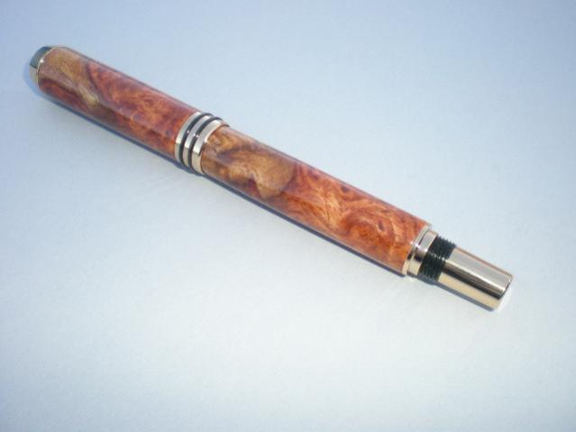

I don't show off my pens very much due to my lack of photography skills, but I thought these turned out well enough to post. This is Amboyna Burl on a PSI Tycoon. The blank came from isaacrapelje here on the forum. It has a small amount of sapwood mixed with the heartwood. The pen was finished with 18 coats of thin CA, which was sanded to 12000 MM and 2 applications of HUT plastic polish. I've been trying out the finishing method demonstrated by Eric Anderson in his videos. Must say I like the results better than the Medium CA/BLO method I was using, and seems to be more consistant than my older method. Thanks Eric and Isaac for the methods and materials. Your comments are welcome and appreciated.

That is great looking. You started with what looks like an extraordinary blank, and enhanced it. Your finish looks great and I think the pictures are good, too.
