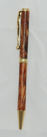

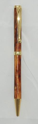

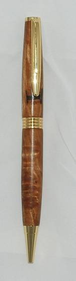

Alejanders Member Joined May 7, 2011 Messages 152 Location Moscow, Russia Jul 18, 2011 #1 Spalted malus, BLO vacuum impregnation. Attachments malusa1.JPG 33.1 KB · Views: 468 malusa2.JPG 33.1 KB · Views: 430 malusa3.JPG 33.1 KB · Views: 441 Last edited: Jul 19, 2011

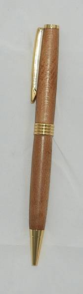

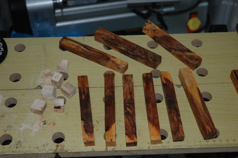

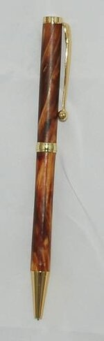

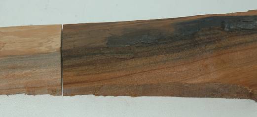

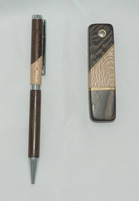

Alejanders Member Joined May 7, 2011 Messages 152 Location Moscow, Russia Jul 19, 2011 #3 I have told about it in the topic Green wood. Vacuum impregnation instead of drying http://www.penturners.org/forum/showthread.php?t=82460 It was just a malus, that 3 years was under snow and rain. After vacuum impregnation wood got so beautyful texture. Cmall light pieces on the left - wood before impregnation. By the way, there is vacuum impregnation (with same BLO) on other wood: Platanus. It becomes worse (less contrast). Middle piece on this pen and thumbdrive - platanus without impregnation: Karelian/Masur birch. It becomes worse too - wood lost curly shine.

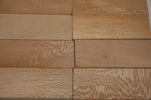

Alejanders Member Joined May 7, 2011 Messages 152 Location Moscow, Russia Jul 19, 2011 #6 Platanus. http://en.wikipedia.org/wiki/Platanus Tree native to Nothern Hemisphere. Have very interestin texture, like licewood, but may be "more random" texture if you cut along grain lines. There is texture from 8 scales. Unfortunately, on small round pen texture looks not so interesing. My scales - from Sochi - city of Olympic 2014.

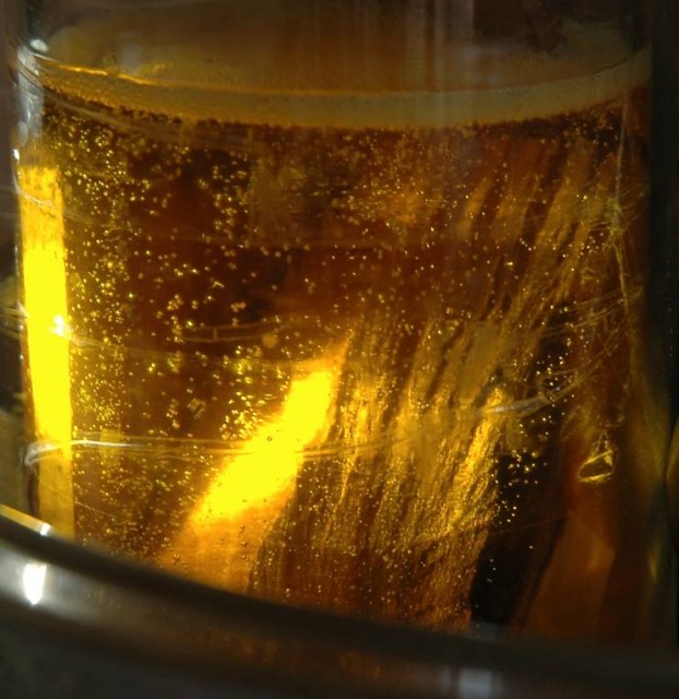

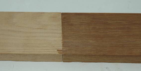

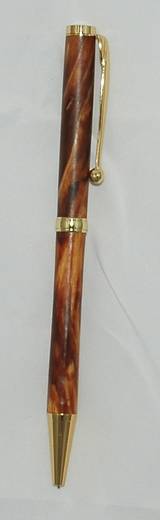

Alejanders Member Joined May 7, 2011 Messages 152 Location Moscow, Russia Jul 20, 2011 #8 Yes, vacuum impregnation does great change (for BLO or pure linseed oil). Wood becomes much darker. Look at bubbles - air leaves wood : For example, there is a result of impregnation with pure linseed oil (from drugstore). oak (left - before, right - after): Malus:
