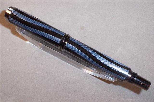

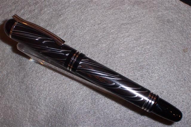

FYI, if you want to see real artistry with aluminum take a look at these pens made by Eagle:
(edited to show pictures directly)
