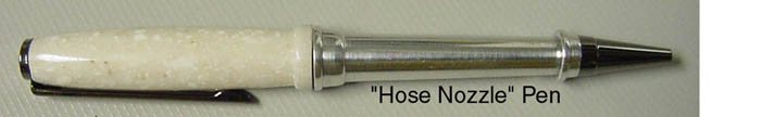

I have turned a few AL pens and it does get hot and slow shalow are essential. I get 6061 or 7075 from a local machine shop that has drops too short for further use but just right for pen blanks. I give a pen or two to the owner or foreman and never been charged. To make the finish satin, I buff it with a scotch brite wheel after sanding and polishing. Its fun. Give it a try. Here is a pic of one I made for a fireman friend...."corian" hose and alminum nozzel.
