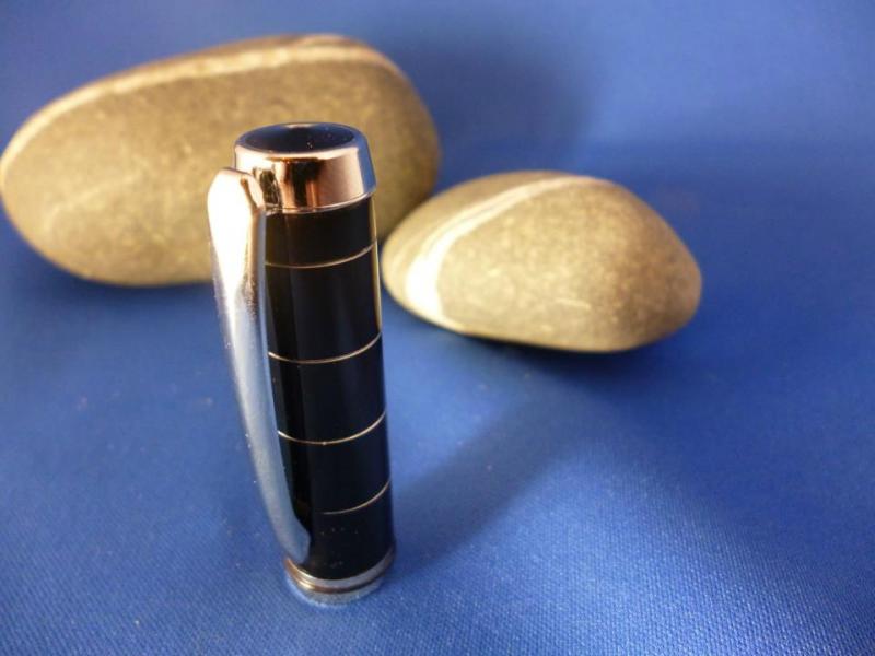

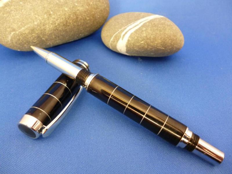

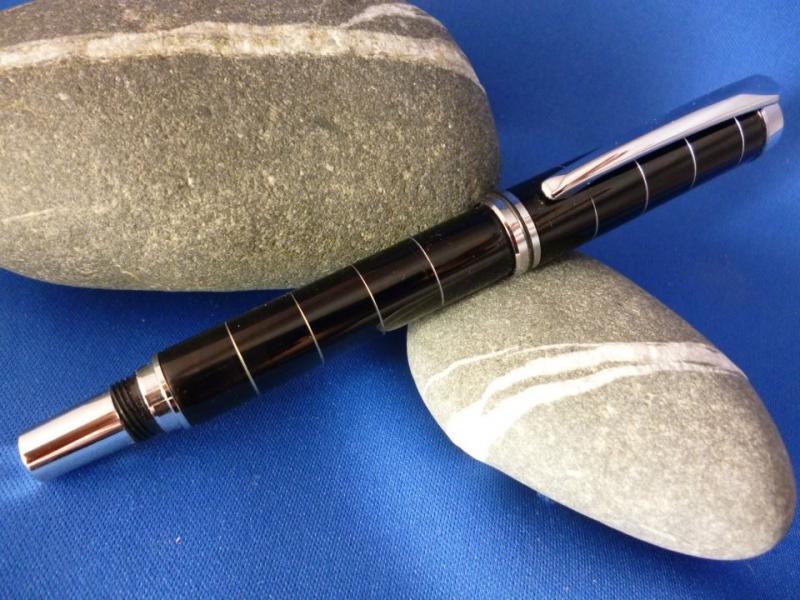

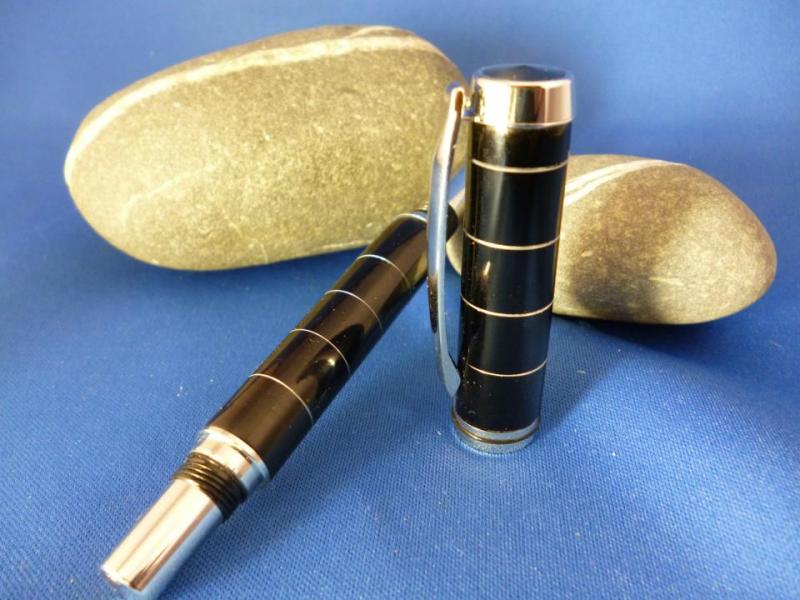

Here's an aluminium pen i have made for an overseas colleague as a gift.
Anodised black with a different approach for me trying to acheive a high gloss finish, which i think i have sussed! - though il let you be the judge? :smile:
As Haynie wanted to see, i've made a video of the whole process from turning through to assembling the anodised pen.
Critiques on the pen or video are highly welcome

Brad, Beautiful pen!! Thanks so much for the videos! Really gave me a lot of ideas and inspiration. If I may, would like to ask a few questions. Did you have trouble putting the DRO on that lathe? Do you use it primarily for the cutting depth? and lol...is that the music you listen to when you are working in the shop? I love it. Doc
my music taste is very varied, from drum n bass, to classical, with ocean colour scene, the doors, buffalo springfield, kosheen, and various others in between.
Enya, is great for chillout and an artist most people know of worldwide leaving it great
The lathe came with DRO's, but they do sell those ones seperately for other models in the range. i couldnt see them as being difficult to fit. i use them for as much as possible. not only for depth, but to ensure the lines are spaced evenly apart. also very handy for "zeroing in" when preparing to taper pieces and anything else.

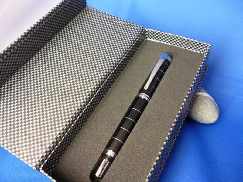

Brad, very nice pen. Thanks for the video. Interesting to watch you work on the metal lathe. Thanks a nice box, too. Did you make it?
unfortunately not, i purchased the box from axminster tools here in the UK :) quite like the magnetic lid closure
Another nice one Brad. Did I miss the polishing process?:rolleyes: Thanks for the videos.:biggrin:
it was so short i didnt even put it in the video :biggrin:
from being removed from the pan, and mounted on the mandrel i put some plastic car polish on a cloth and rubbed it down for all of 10 seconds. and hey presto... a shine like that. they key was not to use the caustic soda (which attacked your threads last time) but to use hot soapy water and scrub excessively before doing the anodising. it avoids the matt finish
