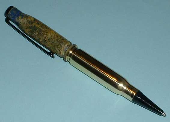

I'm posting this one because the raw materials come from IAP suppliers.
Gary Max supplied the 308 casing.
Curtis Seebeck aka MesquiteMan cast the alumilite blank for me.
The kit is a black enamel CSUSA slimline.
I painted the inside of the tube using Blue Testor's RC Model paint.
After skewing the blank to shape, I wet-sanded with MM and put on two
light coats of CA then buffed everything with a carnuba top-coat.
Thanks guys; y'all done good.
Gary

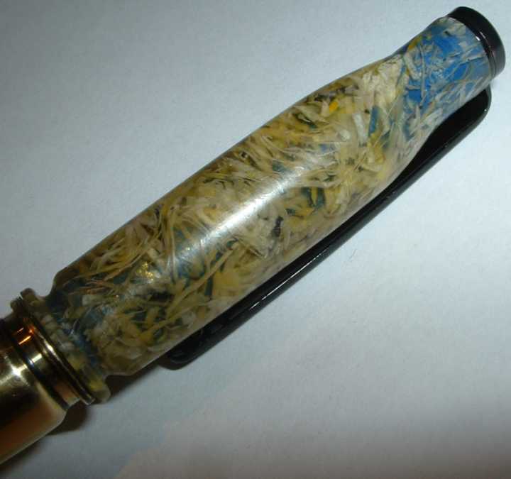

Looks interesting, Gary. Do you have a brighter pic by any chance so we can see the marvelous casting that was done?[:D]
Also, just to clarify, the casting is NOT cactus. I will let Gary tell you as much as he chooses about it.
Curtis,
I'll be buying fresh batteries today and take a new photo tonight. The casting is not only well done but much easier to turn than I anticipated. [8D]

The blank is shredded paper I sent to Curtis which he cast using Amber Alumilite. It's the same casting material he uses to make the cactus blank.
Thanks,
Gary
Originally posted by MesquiteMan
<br />...Do you have a brighter pic by any chance so we can see the marvelous casting that was done?[:D] ...the casting is NOT cactus.
That's right, and all the mistakes are mine. The casting is quite well done. [^]

This stuff turns very nicely. [8D]
