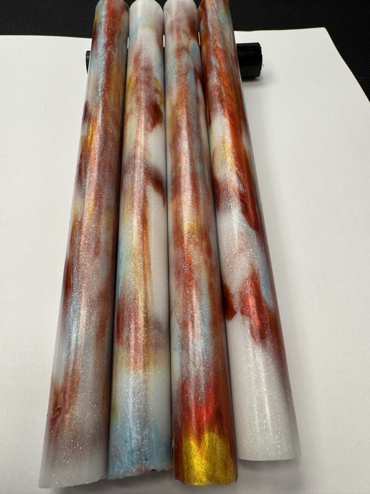

I'm fairly new to selling pen blanks and wanted to introduce myself and share some of my work — and also get some honest feedback from folks who've been doing this a lot longer than I have. My day job is healthcare and casting resin has turned into a massive stress relief for me and creative outlet.
I've been casting Alumilite resin pen blanks specifically for fountain pens, rollerballs, and custom builds. All blanks are pressure cast at 50 PSI.
I recently opened an Etsy shop (SugarKaneBlanks) and listed a few styles to test the waters. I'm not here just to advertise — I'd genuinely appreciate advice on:

These blanks look muddy to me. What temperature are you pouring? How many are you pouring in a batch? My guess is you're pouring too many at a time, causing you to pour below temp.
Pouring 4 at a time (1 mold) and typically pouring around 90-105 degrees. The hardest part is running from the basement to garage to get it under pressure in time. Weather has been all over the place here which is making it difficult to keep a consistent starting temp but getting some improvements after starting to work in the basement. Thank you for the feedback I appreciate it.
Why don't you just store the resin in a consistent environment, but still do the pouring in your garage? From my understanding, but could totally be wrong, it's less about the ambient temperature and more about the temperature of the resin itself.
Was doing that, but then I was freezing. Im from the desert still adjusting to the midwest. Maybe someday I will be tough, but today is not that day. Never in my wildest dreams did I think i would learn what an "ice storm" is.
