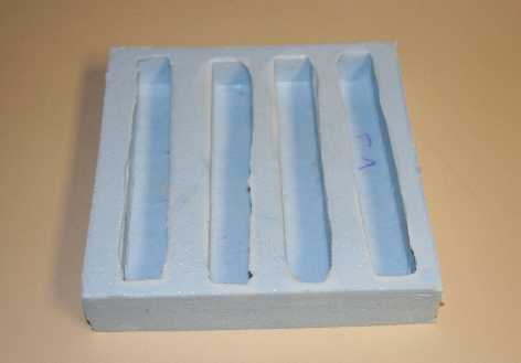

Gadget's molds are pretty great, but I'm impatient. Therefore, I poured my own yesterday evening. I popped it out of it's mold a few minutes ago.
