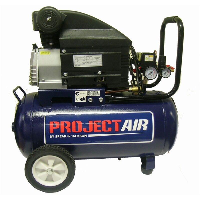

Unit i have is similar to this. It is a direct drive, 2.5 hp with a 40 litre tank.

Tiger; As others have said the tank should hold pressure for a long time. I turn off the compressor when I am not using it regularly, and it will hold pressure for weeks!
Then Randy i don't know what i could have done wrong, i set it up as per the instructions, have got teflon tape on the fittings and it's never held pressure for more than 1/2 an hour.
Have you checked the drain **** underneath? If you have checked all the fittings other than that it may be leaking back through the compressor.

Like was mentioned earlier, you probably have a leak at a fitting. Just because you used Teflon tape does not mean (1) you used enough some times time it takes 6 0r 7 turns (2) it is seated correctly. Again like was mentioned earlier use dish soap with water, brush it on the fittings you will see straight up if there is a leak.
This can be a pest to track down. Especially if you have a lot of runs, like in PVC pipe to different points around the shop. Just have to be patient and check every connection.

Another possibility could be in the upper end of your compressor cylinder head. Most compressors like this use reed valves to control compression and air flow. Depending on how many cylinders your unit has, you would have an intake and discharge set of reed valves for each cylinder. If any of them are not seating fully, it can allow a small leak back into the compressor. Many compressors have a check valve on the discharge piping to also help prevent bleed-back into the cylinder(s). Just a thought.
