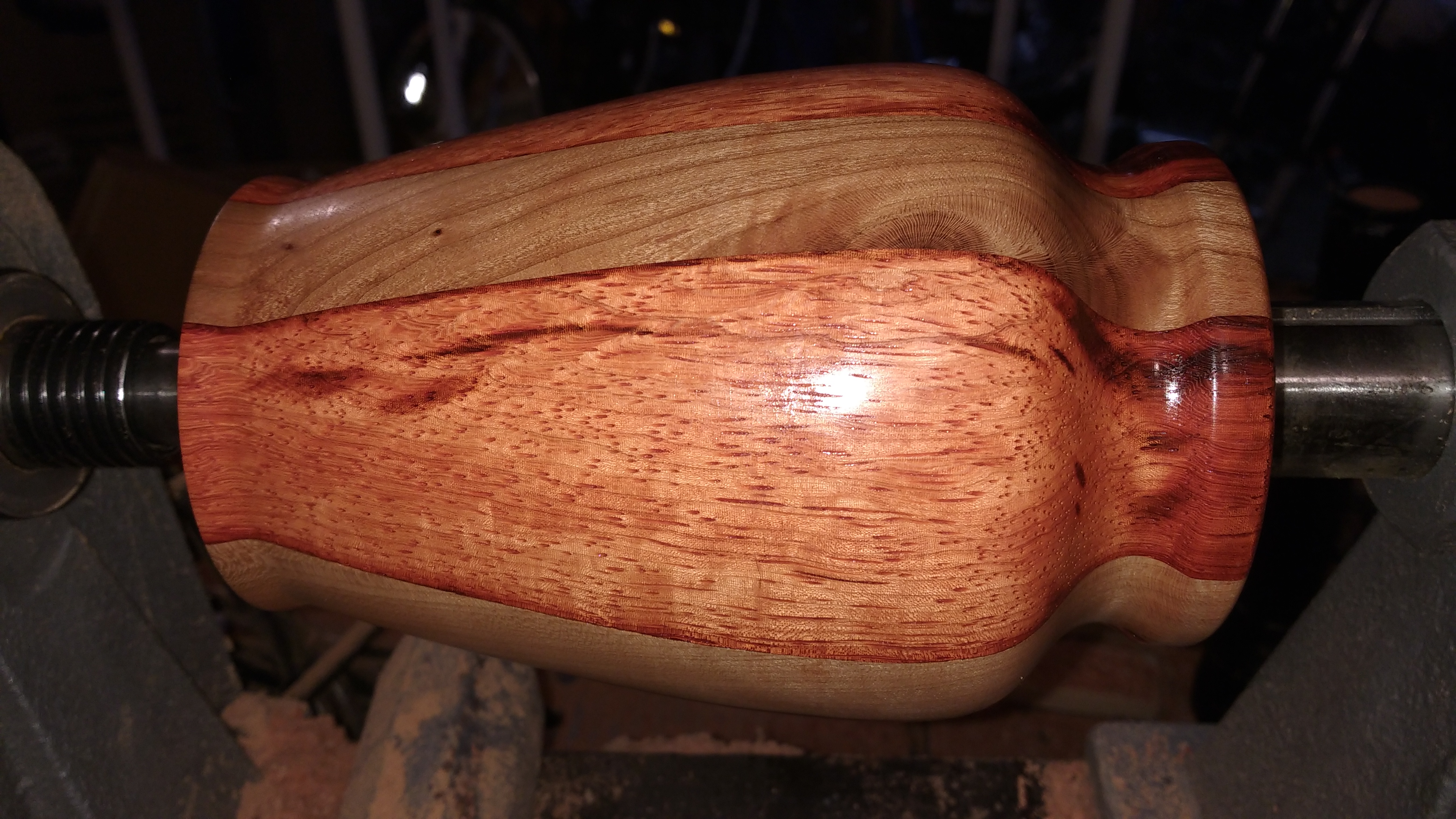

I have been playing around with Tru-Oil and Armorall. Crazy but it works.. Popular for Gun stocks and knife handles.
How To Woodstock's Elixir: Armorall and Truoil finishing handle material
View in Gallery
I use Tru-Oil filler and finish on my gun-themed pens. Back in the day I used it when re-finishing rifle stocks. I've no data on how it holds up on pens yet. It does make a nice matte finish on Walnut and feels really nice. Will check out your link on adding Armorall.
