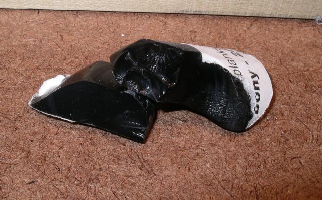

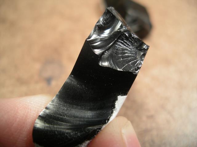

I don't usually turn plastics, but I ended up with a piece of this as a freebie with an order. As I was thinking about what to do with it, I fumbled and dropped it, and it broke. The floor is thin carpet over concrete. The fracture line is smooth and curved, like obsidian.
I haven't turned it yet, but from that experience, I wouldn't hesitate to refer to it as brittle. And I can't imagine it looks or feels more like ebony than any other black plastic.

It sounds like there may be two different materials under discussion. Is it possible something else got mixed in and inadvertently sold as alternate ebony? Or just a bad (brittle) batch from the manufacturer?
Here's a photo showing the way my piece broke.
It APPEARS that piece is square.
Alternative Ebony comes in a rod, round.
So, yes it appears we are talking about different materials.
From that angle, it is definitely Alt. Ebony.
And yes, I believe it is VERY possible to have a "defect" in the material. They make these rods by the meter--I would be very skeptical if they said they were all identical.
