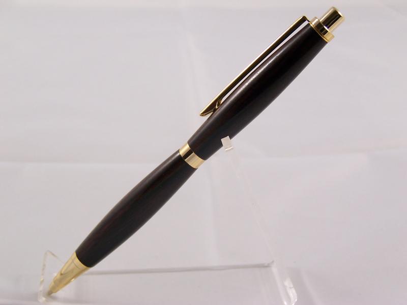

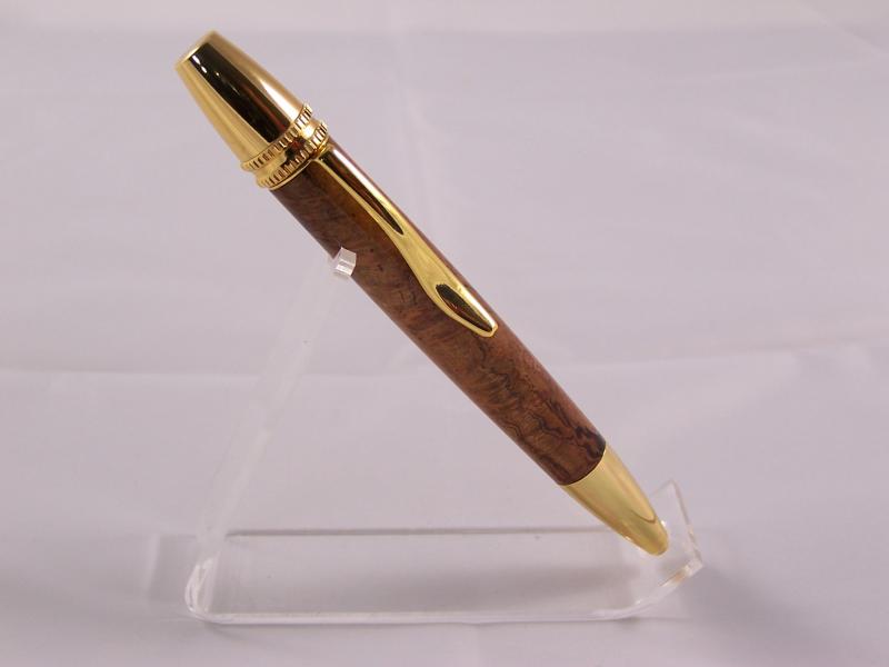

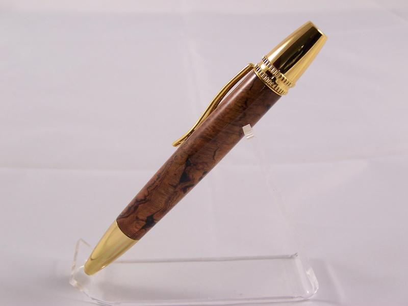

Ok, so first i got this kit to try out the 1 tube style, and i like it except for... that it is pretty short. But maybe that is a good thing. I am going to try the sierras next instead of the polaris'. So the first is a cherry burl that i got from my dads friend in oregon. (he makes the nicest chisels ever!). I picked up this blank and i thouht i would try it, it was covered in some crap so i thought it was just some funky blank. But then i cut it and i was like, hey this is cherry burl. I turned this with 1/2 bowl gouge and my dads woodchuck rougher, or something like it. and then i sanded to 600 5 coats of thin ca with accelerator in between coats, then 600grit and mm to 12k then hut plastic polish. The next is a ebony pencil that i got from the same guy. I just did a friction polish on this cuz i kept messing up on the ca finish, and almost threw it across the shop after like the 4th time messing up. I just had to use this kit up. This was one of my first kits that i got from wc in spokane. Ps if you wanna see his chisels its http://www.bluesprucetoolworks.com/. all criticizes are welcome.

Nice pens, the slim is a very elegant look...
My wife and kids absolutely LOVE the Polaris/Atlas/whatever pen kit. My wife tends to confiscate more of my pens than I do, but if they would just make the circuit boards and laser kits for this series, she would probably only use them...
From a turning perspective, i also find them interesting to make, as there is a fair amount of freedom to be had between the ends, and even at the top, due to the wide spacing under the clip. I've taken to rounding out the upper end to a pronounced circular profile, which makes it so you don't even need to use the bushing or measure the end...
Both are nicely done -- good looking blanks turned into great looking pens. I especially like the cherry burl.
I've never actually done an Atlas/Polaris. How is the balance?
