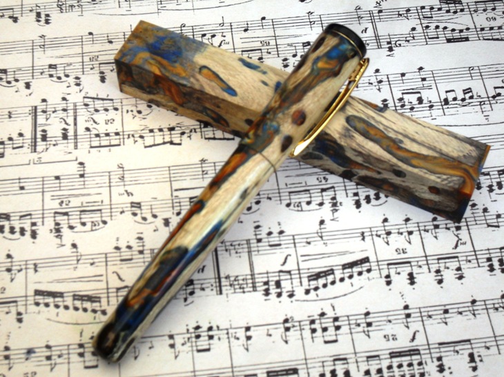

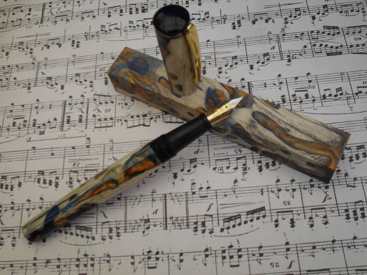

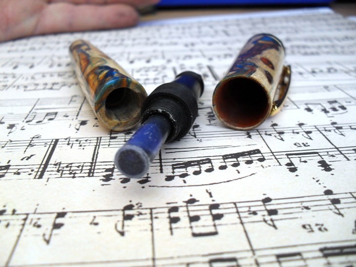

the length of the pen is up to you this one finishes at 145mm and uses a M14x.8 triple start thread for the Cap, the tail tappers down to about 12mm (1/2") as a result the cap post on the body
the cap has a 14.2mm hole drilled into the timber and an acrylic sleeve inserted inside the sleave has a 13mm hole drilled halfway down then 12.5mm
And as for the Cap as again it's up to you this starts at 14.7mm and finishes at 16mm

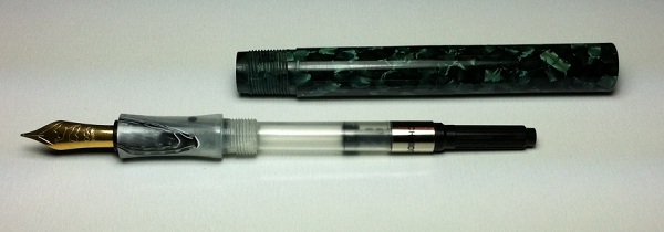

Well I never really thought I got a good answer to the placement of the converter except I thought everyone was saying it was up to my personal taste. So yesterday I was trying to make a section and I think I found out the hard way that the length of the section is critical. Looking at how the Schmidt converter connects to the feed housing it sure appears like you need those two pieces to "engage". The part of the converter that will slide into the section is close to 1/4" diameter while the main body of the converter measured near 0.28" which doesn't leave enough material if you have 9mm outer threads on you're section. So that means you're section length is limited because if it's too long you won't be able to drill out the inside for the 0.28" body to fit. So I concluded you need to insert the converter into the feed housing and measure the distance from just inside the front lip of the housing to the back of where the 1/4" part of the converter stops. From memory I think it will come close to 1.25". If you make the section shorter then the converter will be fully engaged in the housing before it fully engages in the section and if you make the section longer than this measurement you are affecting how deep the section will be able to engage the feed housing. So you could be off by a small amount and it should still work but I would probably error on the slightly longer side of this measurement.

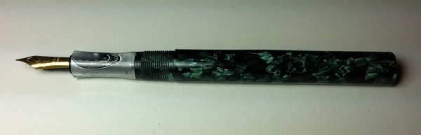

Here's my progress so far...the body is a material called Invisavue Acrylic from Woodcraft. It feels quite brittle. I didn't go for the shape I really wanted because I was worried about the material breaking and I just wanted to have something to show for the hours invested.
For the section I grabbed a piece of scrap acrylic I had lying around. I'll go back and try again with the ebonite now that I got the measurements down. Plus I need to make the cap.
