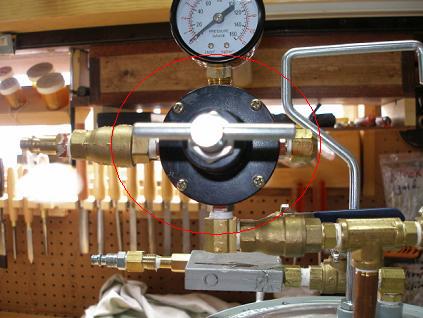

OK Joseph,
This is the regulator we are talking about. It came on the Harbor Freight pressure pot. I believe I have the direction correct that you turn the knob. If I am incorrect, just turn it the other direction. You really cant hurt anything by turning this knob. It's there to adjust the air flow into the tank. You simply hook up your air supply and turn the knob in or out until you hear air entering the tank. As your gage nears the pressure you desire, begin turning the knob in until the air begins to stop entering the tank. You can turn the knob to fine tune the air pressure in the tank. Good luck and write again if you still need help.
Thanks for the input I turned the knob every wich way and can only summize that it was faulty out of the box. The problem has been overted with some spare parts I had in a box.
