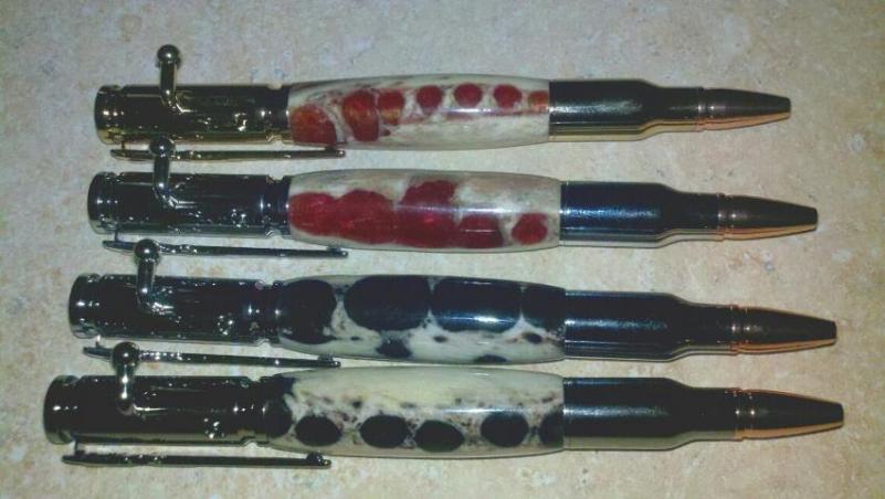

Thanks for all the advice, guys. Here's how they turned out.
