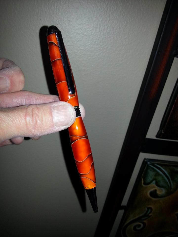

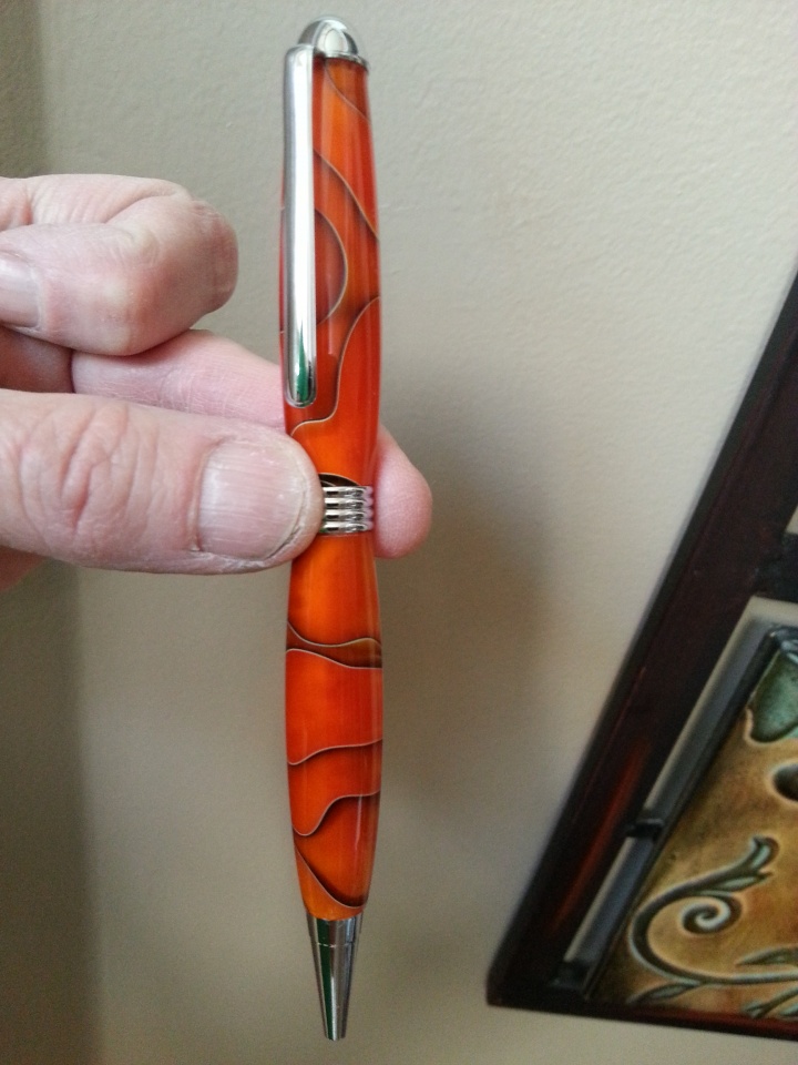

Hi Folks:
I have to agree with many of you, this is a very night kit.
This is my first shot at one. I may replace the finial with a black mesh stylus.
My light box was almost finished, but I dropped it off my deck while spray painting the legs white. I need to replace some of the legs.
So here's my hand again :biggrin:
I painted the tube white (I always have problems with CA and painted tubes bonding).

Tony, a while back I switched to 15 minute epoxy from PSI after gluing a tube halfway in the blank. I haven't had that problem since, and it also doesn't react with the paint. I also stopped painting the tube when some paint scraped off it when inserting it into the blank. I got myself some Testors paint used for models and now paint the inside of the blank and also put a dab of paint in the epoxy for good measure. The pen came out nice by the way, I like the round top better than the flat top version,
Bill
My first pen was a flat-top Streamline (same kit). I've bought a number of these kits in both flat and round top. It is my favorite slim-style kit.
And I've used that same orange acrylic blank, too. Good looking pen.
I still have that first pen I made -- I keep it in my car so I always have a decent pen with me. I just recently pulled it apart to refinish the walnut blank. The friction polish finish was pretty dull after about 3-4 years. The gold finish still looks pretty good.

For some reason. when I used the flash it came out black. I accidently dropped my light box this pm. so still taking picture the old fashioned way.
