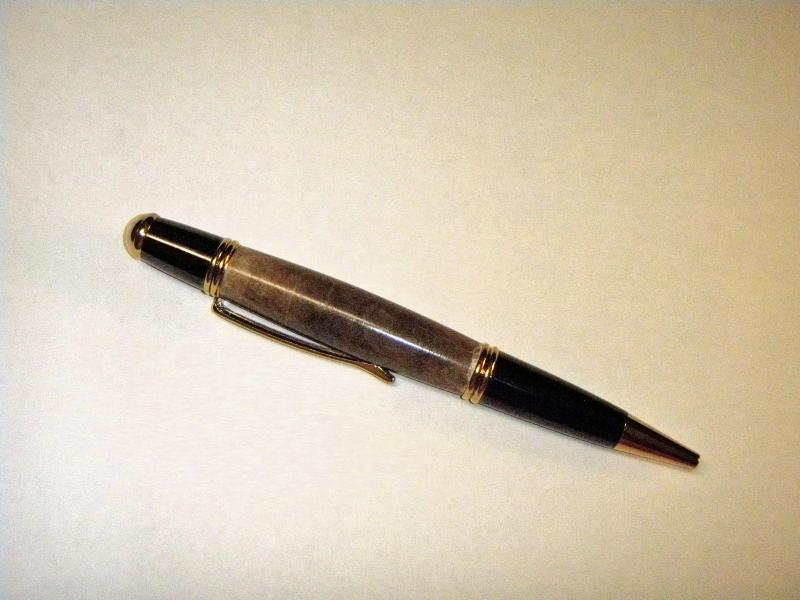

This is my first try at an Alabaster Pen. I choose to use a LeRoi to keep the barrel short. Going to have to leave the ends a tad proud and the LeRoi allows me to do that because of the rounded bands. I drilled and used Devcon 2 ton Epoxy with an overnight cure. Seems to work out rather well. Turning requires a light touch after rounding. To round I used a rasp then went to a woodchuck and finished with a skew and sanded from 80 to 600 then MM to 12000. Compounded thre grits and waxed.
