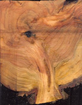

This is a first for me. I decided to bring home a cherry root ball from the recycling area. Here are the highs and lows of the adventure so far. An incredible cross section, but notice the black area the size of a penny, and the change of cut? That's gravel and dirt, ARGH!!!!!!!!!!!!!!!!!!!!![xx(][xx(][xx(] In fact that's the second bandsaw blade. The first little "bump" was a piece of granite the size of a whole pecan. I'm not stopping, but the cost of blanks going up!!!!! Not really, a friend gave me some blade stock that I weld up at work. I sure do hate changing blades all the time though, and the roll won't last forever. Anyway there will be some blanks available latter.
