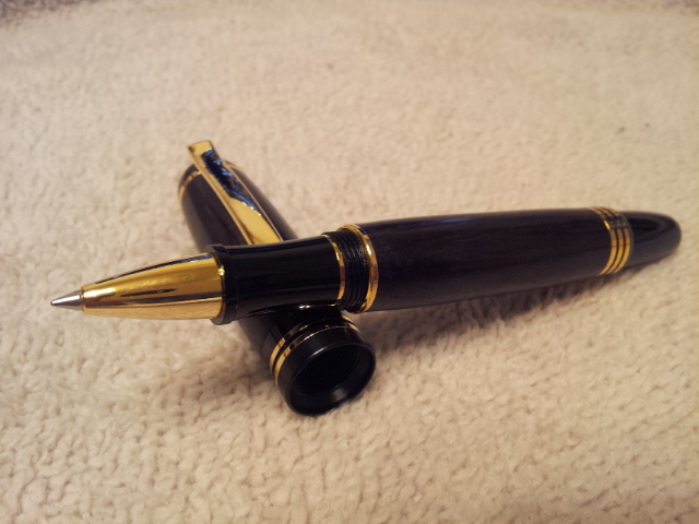

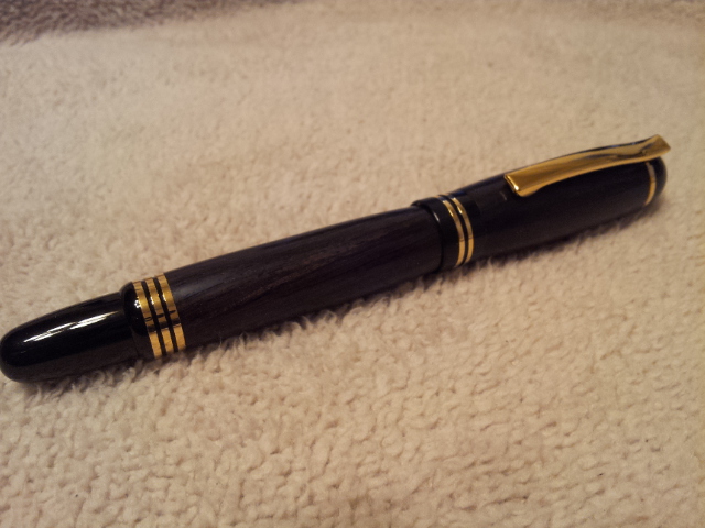

I turned this Churchill from African Blackwood. First time I used it but definatley won't be the last. Turned very smooth , take small passes. I actually wet sanded this pen to 12000 and used Crystal coat. The wood is awesome. Do yourself a favor and try it , it will soon become one of your favorites.

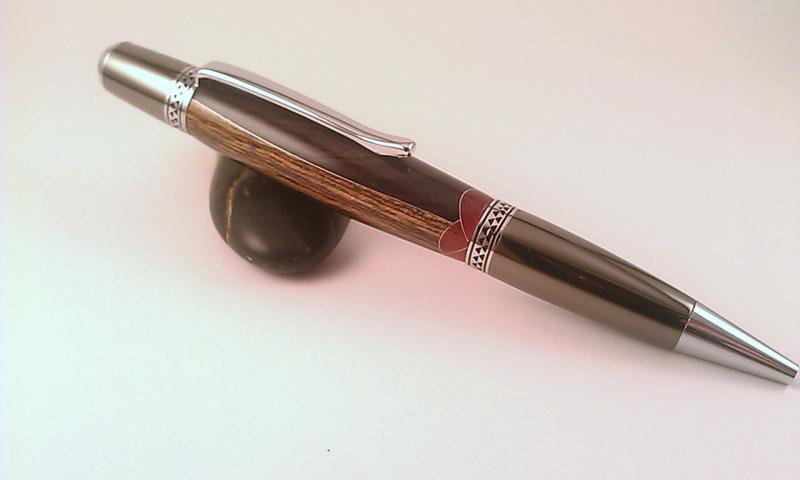

Segmented with some Lignum Vitae:

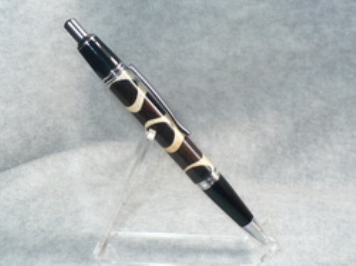

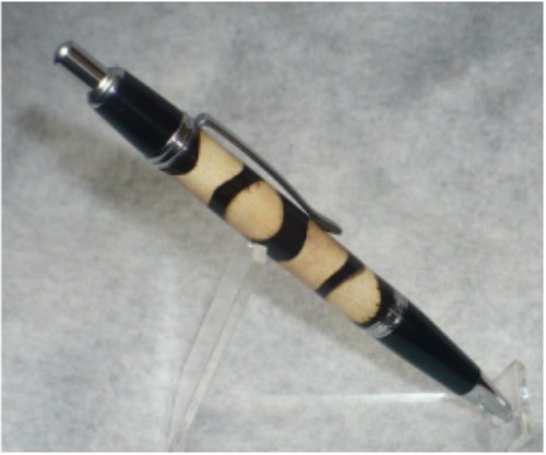

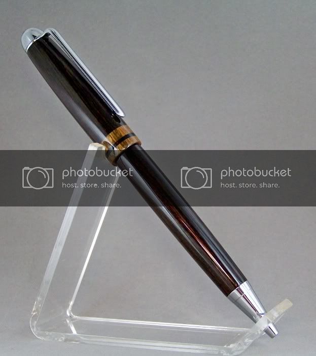

I love blackwood. The last piece I bought was 4 3/4"x 5 1/2"x 1 3/8" and cost $18. As was already said, the black will bleed into the lighter colors, especially when sanding. I've learned to turn it down and then soak it with thin CA to seal it before sanding. Sometimes I have to soak it 3 or 4 times. Here are a couple of pens with blackwood and holly. On the black one you can see the bleeding.
