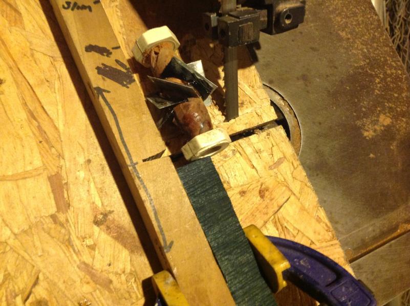

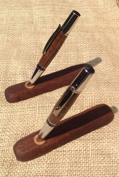

I used a version of Skiprat's nuts(thanks Skiprat for the tutorial) made from PVC fittings to inlay this aluminum....my kerf is a little wider than th material, I need a new blade. This method is really easy and provides accurate results....give it a try if you haven't.

I am sorry if you want us to enjoy your fruits of your labor you need to provide us with some better photos. Not a slam just a critique. Can not make out what you did to the pen that require any of Skips devices. Thanks

I do not know anything about Ipads or any of that stuff. Just the angle of your photo would have been an improvement. Loking down on top of a pen shows nothing. Take the photo from the front and face whatever it is you want us to see. I am thinking there maybe some kind of segmenting there but just not sure. If it is not worth the extra effort to show us some good photos then is is not worth our effort to comment. Just the way it is.

I like the pens, but I do not see nuts. Segmenting looks good also.

Here's one I have glued up....Turned round, PVC nuts, 2 dabs of CA, square it up and start cutting. I drill after it's trimmed.

Thank you Sir. Now I get it. I am a long way from segmenting. But I enjoy when people post them and explain how they got it to happen. Gives me thoughts for the future.
