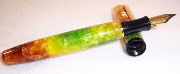

Keying in on the hilighted phrase above and after making many of the kit pens, I would recommend an El Grande since it uses a nice black nib holder rather than a plated metal holder and you can easily trash the end cap and make a "closed end" pen which will really showcase the wood. You can also modify the upper cap to show all wood as well. I make both the Ligero and the El Grande pens using 3/4" blanks with no problems.
The nib that comes with the kit is pretty decent but you can always replace it with one of Lou or Anthony's gold nibs.
The pen below is a "Double closed end" ElGrande with both the upper and lower caps replaced. Notice the nice non-metal looking nib holder? Imagine how this would look with a nice Bethlehem Olive Wood blank! I think it would really showcase the wood rather than the kit parts!
