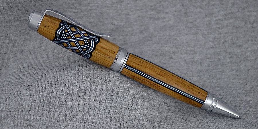

Thank you, Gary. It was a backup entry for the 2016 BASH Ballpoint Contest. The piping on the lower barrel was supposed to be 8 stripes to complement the 8 loops in the knot, but I made a mistake cutting the grooves and had to settle for 4 stripes.
