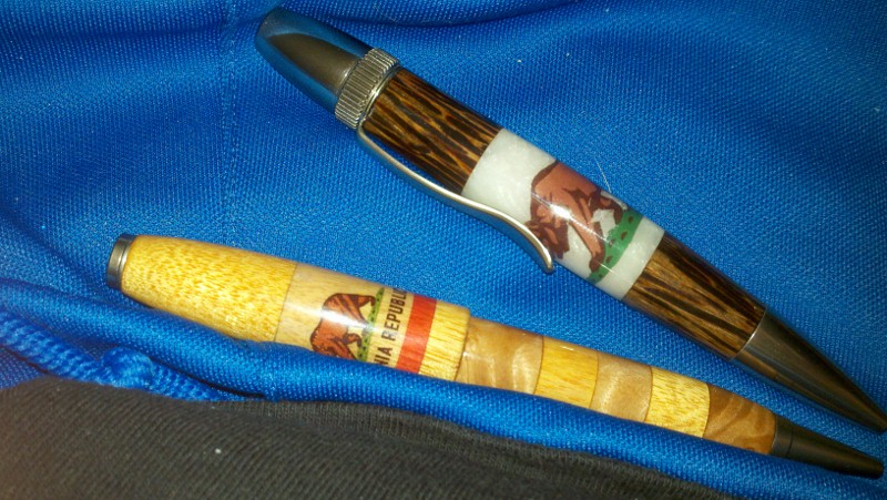

I have been using Avery Clear for all of my decals. Here is what I do and it works for me. After I get the picture reduced, and sized pretty good I use the Avery website (which is on the box) size them to the size I want and copy at least one page. Turn my blank, sand it to 600, four coats of thin CA, then I put 3 coats o medium CA. I do not use accelator in between ANY coats of CA. I then smooth out the CA'd blank with brown paper bag, just to have a smooth place for the decal. As the clear label has a stickum on the back of label it stays pretty good where placed. I then follow up with another coat of CA by placeing a dab on Bounty piece and by turning the lathe by hand place the CA directly on the label and turn the blank by hand. I then put at least three more coats over the decal. Finish it off with as many coats of CA as you wish. Whan you wet sand the blank DO NOT be too hard on the blank as you might cut into the decal. finish off the polish as your choice. I posted a picture of 4 or 5 pens with the Globe and Anchor on it several months ago. I find it is best to have a smooth place to lay to decal, and at least three coats of CA over the decal.
got pics
