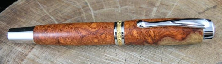

I made a beautiful Statesman in Amboyna but I was still learning my high gloss shine method and its not very shinny.Is there a way to shine it up in the post made phase ?
thanks

Keep rubbing it with a soft cloth.
Do this for hours if not days on end while watching the tubeor drinking your coffee.
When you think you are done do it some more.
TSW will help also.

A short lesson in wax might be in order.
Wax has a poor water resistance. Carnauba is better than most other waxes because it is harder, but it is too hard to use in its natural state, so softer waxes are mixed with it to make it useable. Those are usually beeswax or paraffin, both of which have a poor water resistance, and are easilly damaged by water. Silicone is added to auto waxes so they won't be damaged by water.
Silicones are not used in woodworking waxes because it can cause all sorts of problems with finishing - "fish eye" in lacquer and shellac, poor adhesion with oil and waterborne finishes. Silicones are very invasive in the shop and will transfer to everything we touch if we use it in the shop and are not careful. These problems may often be overstated a bit, but woodworkers choose to not use any automotive waxes in the shop because that is the easiest solution to the problem.
That doesn't mean you cannot use it on a pen. Just be careful with it. Treat it like what it is - a contaminant that can cause you harm. If you don't, you will be back here asking why you are having finishing problems.

I've sold TSW for a while now and am sad that it is discontinued. Do I believe that it was bogus in any way? NO!!! I'd rather not see a good man dragged through any more crap. (Edit in: this statement is referring to Lou) Nuff said! So, shall we get back to this beautiful pen? It really is gorgeous, good job with it, Dave.
