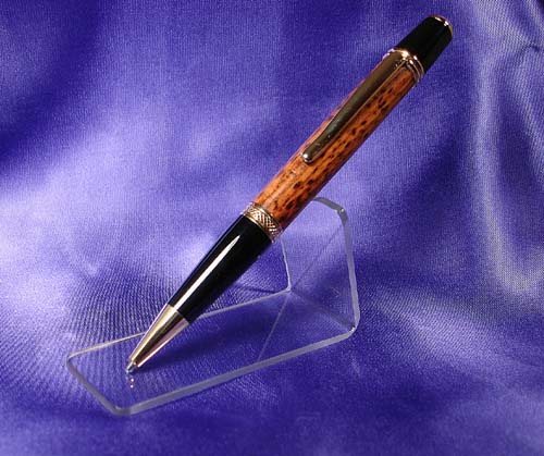

Below is my 10th attempt at making the stand. If only I would of followed Dario's instructions things probably would of went easier. I figured if a candle was hot enough to make the bend that boiling water should do the trick. No such luck, it didn't make it plyable at all.
My next several attempts was to use a blow torch. That didn't work out so well either. Kept burning the plexi. I then tried a variation of Fangar's method by taking the glass off of my halogen. But since I couldn't get the entire piece in, my bends kept coming out crooked.
My last few pieces I held over my electric oven. That worked out pretty well for getting the bend.
Next came the finishing process for the edges. I tried sanding, I tried the blow torch. Neither of which came out very well.
Moral of the story? FOLLOW DIRECTIONS. If I had followed simple instructions I think I could of avoided a lot of frustration. I would have made the cardboard pattern before my 6th attempt. I would of sanded before making the bend. And I would of tried the candle method.
Lesson learned for me. Anyway, the picture below will not be my final product. I ran out of plexi, so gotta wait until my next run to Lowes.

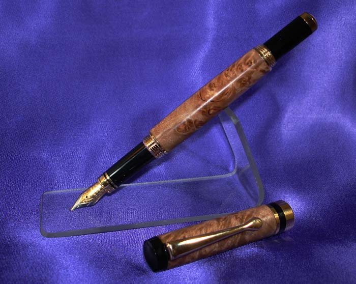

Ok ok ok....I learned my lesson. I followed the directions this time and had success. Picture below is the result. The only thing I changed on the directions is after sanding with 150 grit, I then used my dremel tool with polishing compound. Then finished up with the micro mesh.
Looking good!
The one I am using is my first and only attempt. I will make another later...because this one is a bit short.
Very nice pens by the way [:)]
Yeah yeah yeah....go ahead...rub it in. LOL....I know, I'm a slow learn sometimes. Again, thanks for all your advise. It's greatly appreciated.
