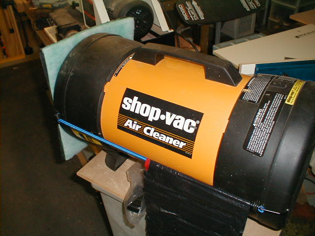

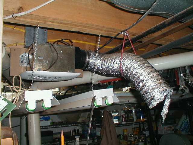

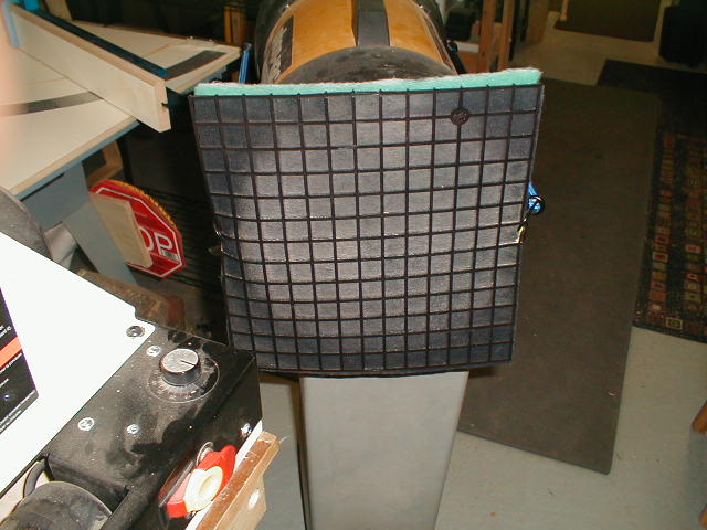

My wife is allergic to the odor from plastic's. So when I turn I need to eliminate the odor. Since my studio is in the basement I need to do some special things. First I added a charcoal filter to the front of my dust filter, see photo 1. Photo 2 is a simple side view of the side of it. Photo 3 is a bathroom exhaust fan I installed over my lathe, as it is directly below her room. The dust filter sits close to the lathe. So far I have turned several blanks without her smelling the odor. Perhaps this will help.
Ron
