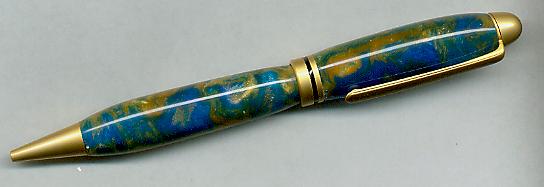

Recently turned some acrylester and it was very difficult. Gouges didn't do well. Best results were using a skew. Had to sharpen it frequently. The results were worth the hassle. Beautiful with lots of depth. Have gone to my local supplier and bought more. Kirk [8D]
<b>Image Insert:</b><br />
<br />
That pen looks great, a lot better looking then mine. But I'm happy I was able to at least get in done without destroying it. I think I dulled every tool I have at least 3 or 4 times. I didn't have much luck with the skew but I don't on wood either. [:D]
