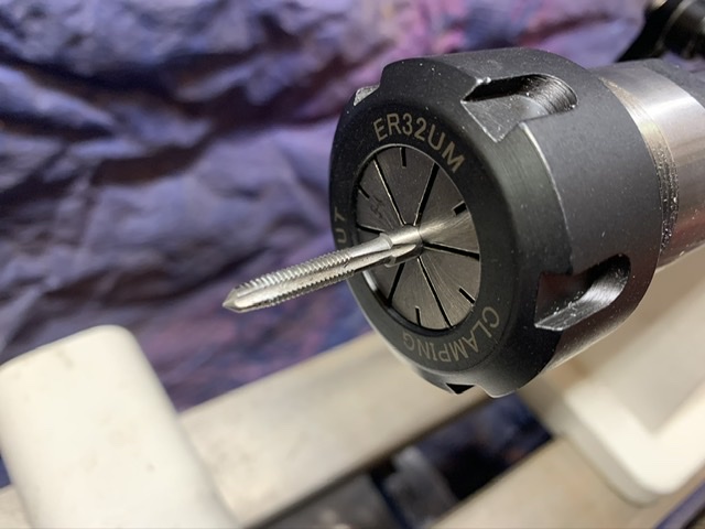

I've had an issue with some specialty taps I ordered in a group buy a while back. They didn't have the 60 degree hole nor a point in the end to use a tap guide. So I modified a design for holding dies to an ER32 collet chuck with a straight shaft. Here is what I came up with.

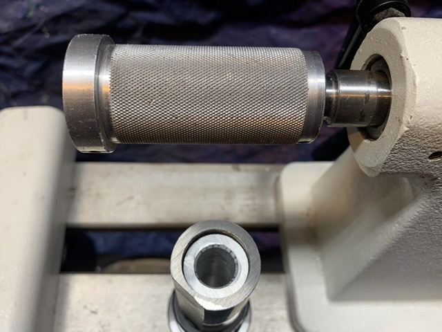

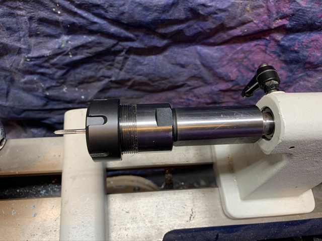

I reused my LMS MT2 shaft from their die guide. This required me to make a sleeve for the collet chuck to fit the ID of the shaft and the OD of the die guide shaft.
It works extremely well. I just locked the headstock and spun the chuck by hand quickly threading a piece of Acrylic. You could also use the motor on slow holding the chuck loosely and let go when feeling too much resistance. It works just like threading with a die.
No more advancing the handwheel on the tail stock while spinning the headstock and holding on to a tap wrench all at the same time.

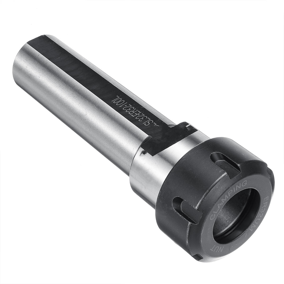

The ER32 chuck was $22 from here: https://www.banggood.com/ER16ER20ER...9.html?rmmds=search&ID=46421&cur_warehouse=CN
i did cut about an inch off the chuck shaft to match the length of the LMS shaft.

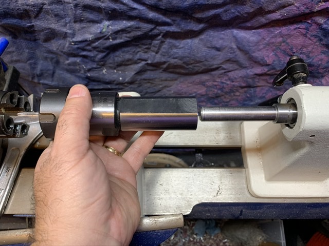

I see your thumb on the collet chuck ... and I see the LMS MT2 shaft from their die guide on the right ... but the piece in-between (gun metal color) to which your baby finger is pointing, did you make that ? (And is that the whole point ?)
The guide shaft that sits in the tail stock was borrowed from my die guide I purchased from LMS. The OD of the shaft is just under 9/16". The hole in the shaft of the collet chuck has an ID of just under 1". I turned a 3" long piece of aluminum to match the collet chuck Shaft ID and drilled it 9/16" to match the guide shaft. I could have made a new guide shaft to match the collet chuck but that would have required me to machine a MT2 taper. Also the ID of the collet chuck was pretty rough so the sleeve I made gave me a smoother fit.
You can see the sleeve in the bottom of the last photo.
(Pinky pointing) That is the straight shaft that is part of the Collet Chuck. It's machined from a single piece of metal.
The only thing I had to make is the internal sleeve.

Danny wrote: "The only thing I had to make is the internal sleeve. "
Oh, OK. I get it. ... Thank you very much for everything above ! . I think this is a very helpful thread. . Thanks for taking time to write/post it.
I now feel comfortable that I know exactly what is going on.
