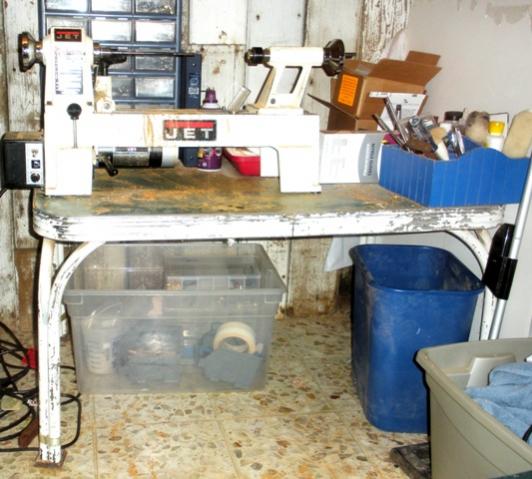

I know I'm not the only one of the hundreds of people on this site. But I haven't seen a "workshop setup" like mine. So I'm going to post it here.
I have some muscle problems from a "cottage cheese brain." So when I decided to start turning things on a lathe, I had my cousin cut 18" from these table legs. I use the lathe from a chair or wheelchair - whichever I need at the time.

cathy, neat setup. i was an ergonomics technical specialist for 3 years and did a lot of workstation design. you have a great setup from what i can see. how high are the lathe centers from the floor. i am rearranging my shop since i finally got the canoe out and would like to make a sit down station. it would save my back and legs from getting tired so fast. anything else you could share about turning from a sitting podition, like what to watch out for, best ways to do something, etc..., would be appreciated. thanks much...................bear

The "floor of the lathe is 29.5" from floor. Mandrel height it 33" from floor.
I know one of the things I watched out for at first was things like blowouts because my face is alot closer to the work than if I was standing.
My tools have much shorter handles. The big handled tools are too awkward. Wearing a dust mask is essential because your "right there."
Cathy Sue, I need crutches to walk due to a bad fall I had 5 years ago so I know what obstacles you have to overcome. I like your setup but I went the other way with mine. Instead of lowering my lathe I raised my butt! I have a full sized lathe so I bought a tall swivel chair to sit at while turning. I also have a chair on wheels (not a "wheelchair") that I use to get around the shop with. I love hearing about how other people with disabilities overcome them and "keep on truckin'".

I have fibromyalgia and often the leg cramps making standing difficult so I also have a stool that I can sit on to give my legs a break when they start hurting. I also have my lathe on a rolling stand that has an adjustable height, which has allowed me to lower the height to where sitting on the stool is comfortable and the changing between standing and sitting lets me be at the lathe longer.
