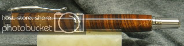

Everything was going so well: beautiful desert ironwood blank with my best CA finish to date...
...and, of course I crack the cap assembling :mad:.
Oh well, I guess I can turn an alt ivory cap and have Ken engrave something like "Don't force it, stupid" and keep it as a reminder. Sorry for the rant but figured several of you might relate! Think it's time to quit for the day.

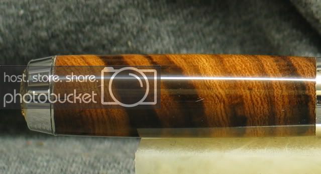

Good point, George, and I should have pointed out what I think is the cause. This is the 1st time I've applied a very thick CA finish and I didn't clean the excess off the cap end well enough. I think just a bit of thick CA finish proud of the end was enough to put pressure on the wood and it cracked. I didn't have the same problem on the pen portion because I'd used a parting tool to trim the CA at the ends to make sure I could get the finishing bushings off easily. This was after I'd had a tough time getting the bushings off the cap portion because of the thick CA. I'll try to salvage it, but IME the crack will still be obvious after filling with sanding dust. I've already glued up an alt ivory cap and will get something engraved on it so I can at least salvage the pen portion and make something positive out of my mistake!

Thanks for the tip, George. I think I've salvaged it at least as a "family & friends" pen. The crack closed to where it's hardly noticeable when I knocked the cap off. I rotated the rough end on a flat piece of 600g sandpaper to knock off the high spots and re-assembled with the crack under the clip. I can't see the crack now without a loupe.
I got a bit lucky on this one and now I know better!
I won't sell it though because I'm a bit worried the crack could expand over time.
