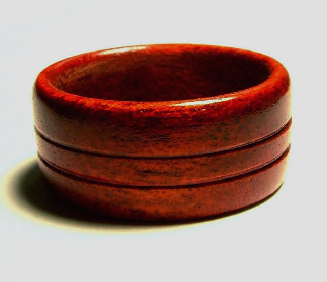

I turned a wooden ring recently for kicks. I've always thought about trying it and it came out pretty cool. It's no Boone creation, but it was fun and it fits really comfortably. I'm not sure but I think it's bloodwood. Comments are welcome.
EDIT: This is an updated picture. I adjusted the color a bit but it still has way more orange in it than the ring does. Oh well.
I had been think about doing this but wasn't sure how to get it sanded inside and out before parting it off. That and I'm way too lazy to do a lot of hand sanding.

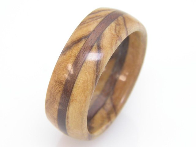

Hey Nils, I did one. It turned out nice. I did African Olivewood with a center of Bolivian Rosewood. It was pretty easy to make and feels good. I made it to my normal thickness.
<br />
Wow, Bruce- that looks awesome! I may just have to try another, seeing how well yours turned out. I especially like how well you matched the grain on the opposing sides of Olivewood. Nice work all around! [:D]
